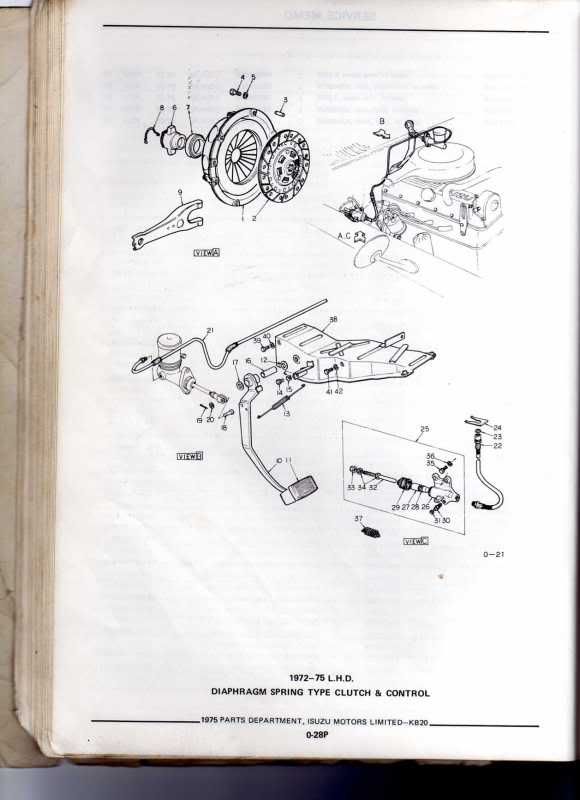

Can anyone post me up some pics of a Hydraulic clutch setup.

I have a 5 speed MUA (2.6L) box here to put in the Luv and seeing as mine is a 79 its got a cable clutch. Can i modify it to take a hydraulic master or would i need a hydraulic setup from an earlier luv.
Can anyone help out with some pictures of a hydraulic pedal and the piviot under the dash??

This is the best i can do, please note its LHD.

Cheers, so if it was RHD it would be offset toward ??????
I had a look at the firewall on my RHD truck and there is no obvious place for the Master cyl to go.
Can anyone help out with a pic of a firewall. Even LHD will give me some idea.

I don't know about you right hand drive guys but i changed my 78 luv from cable to hyd. and it is fairly straight forward and easy.
First i pulled the complete pedal asy. out then you can see on the firewall reinforcement panel inside the mount holes for the hyd. master cyl. this is a carry over from the the early hyd days.I then matched a hole saw to the center hole and drilled it out then drilled the mount bolt holes. Now all you need is the hyd. pedal asy. and the master cyl. plus the tubing and slave and you are good to go.In my case (custom) i used a willwood hyd. asy. but every thing from a early hyd. setup is a bolt in and i assume that you guys had the early hyd. trucks.
I hope this helps you out and you get up and running.
