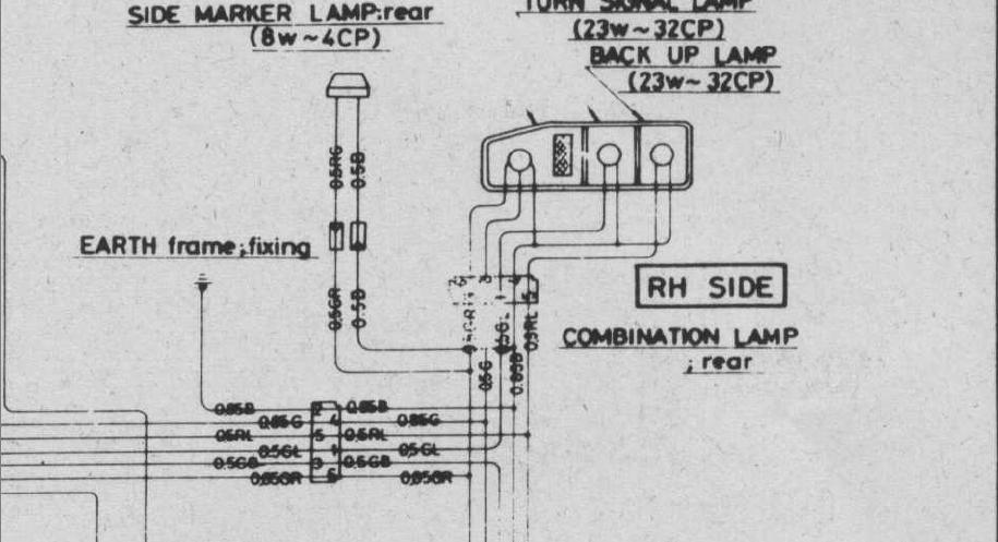

I took the bed off this week, I wanna go take it to the car wash and clean it up before I build the flat bed. I need to wire up some lights to be legal. I bought some lights, at a garage sale, from a newer model GM cab & chassis. The lights are darn near exactly the same wiring as the LUV, being separate stop, turn and B/U lights. I just wanna know what all the wires are for. I have a 1980 4X4 short bed. Any help would be greatly appreciated. Thanks Lee

I don't know if you can make sense out of this, but this is out of the factory wiring diagram.
The full diagram is located at http://www.luvtruck.com/PDF/Series9&10.pdf
Hope that helps.
