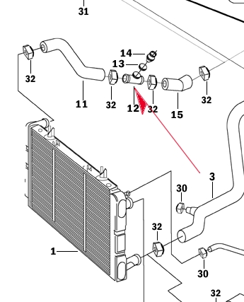

I'm not sure if any other euro cars do this, but Saab uses a T inline in the radiator hose to mount the AC temp sensor. I'm not sure of the dimensions of the hose, or the pitch on the T. If you want both senders for your Luv, using this setup might be a way to install a second sender.

Yeah I was wondering about that. I thought I would do that with the original temp gauge because it wouldnt have to be as accurate.
