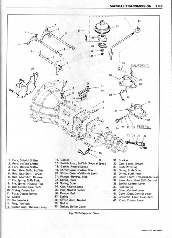

Had backup lights, thought it was just a bad ground, fixed THAT problem, still no backup lights! Where is the switch located that turns on the lights when we put it into reverse? Specificaly, I mean, as it looks like we need to replace it. I don't want to have to tear the whole cab or tranny tunnel apart, just get in and get out and replace it. Thanks!!!

The actual switch is on the transmission and gets activated when you put the transmission in reverse.

Looks like it's on the driver's side tailshaft housing...

Thanks very much! I hope mine is the same. I dunno why, I thought it must be up near the shift lever, looks like I was wrong, but this should be much easier to get to! Now, if I can JUST find a new back-up light switch... :(
