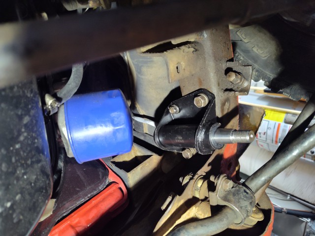

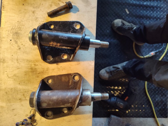

Thx for the response. I ended up just taking out the whole original mounting bracket and shaft and replacing it with one from a 85' trooper. Lined right up, all I had to do was drill the bolt holes out a bit larger.
