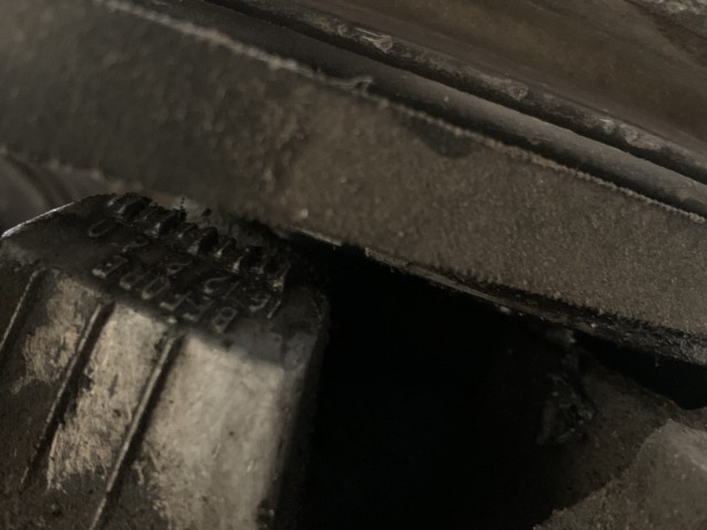

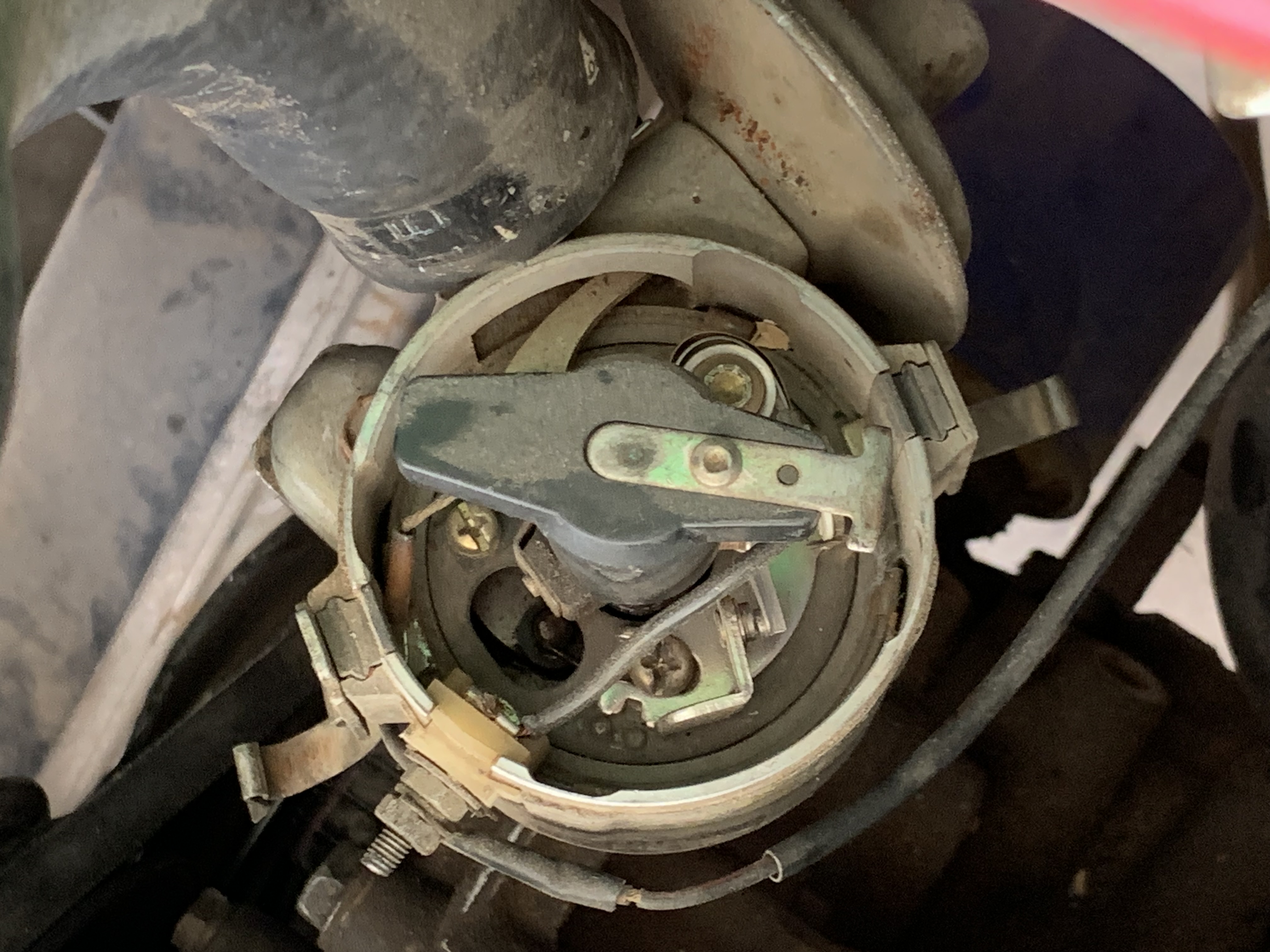

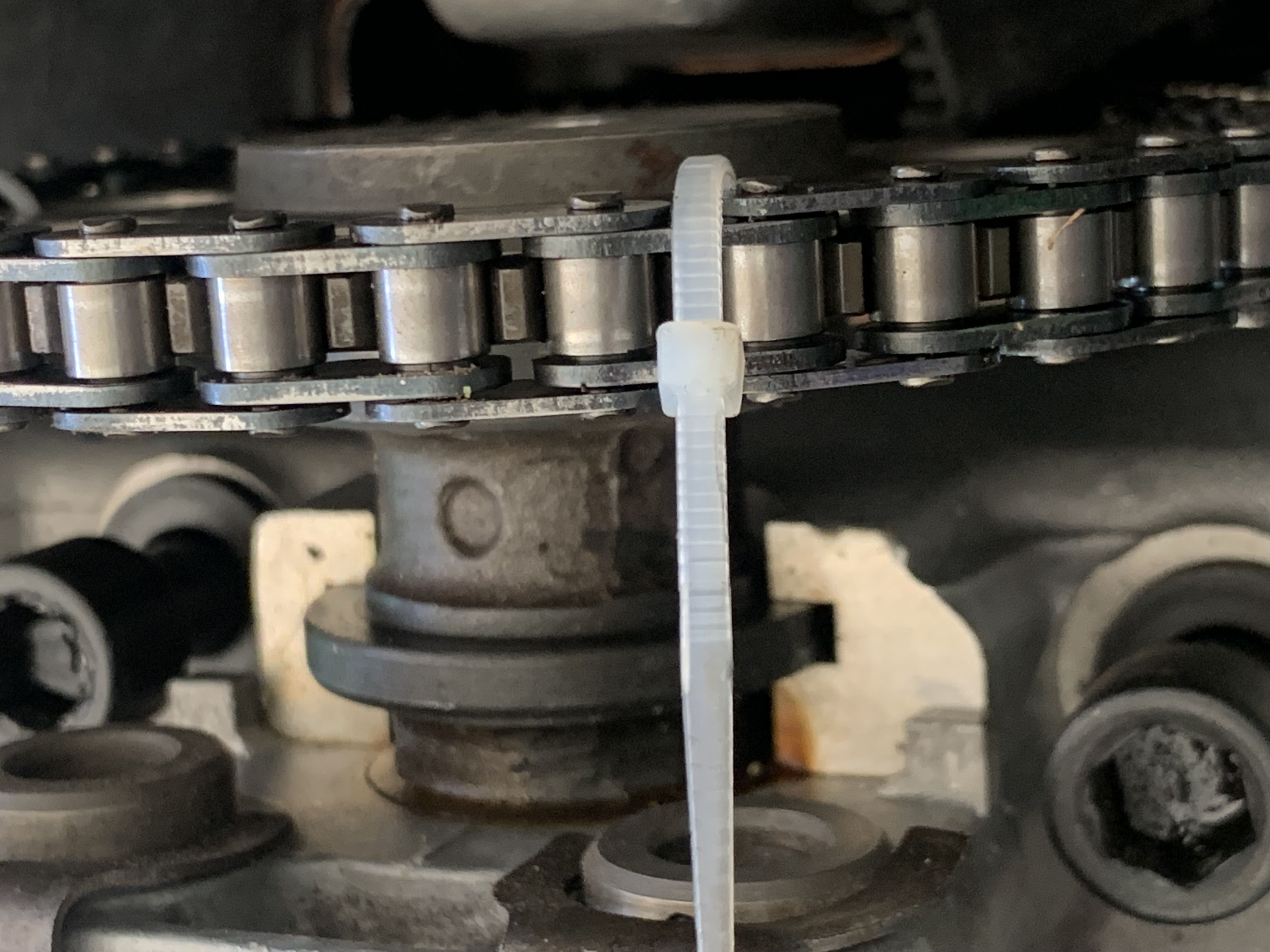

Not sure if these pics will help, but here are pics of the camshaft/timing sprocket alignment, the crankshaft timing, and the distributor.
