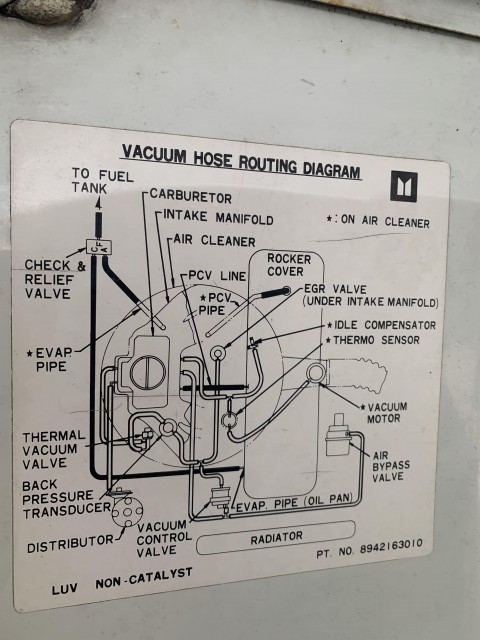

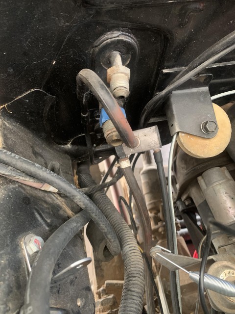

Good evening, I am wondering if a hose is supposed to connect on to the vent coming out of the right side of the oil pan. If so where should it run to? Thank you in advance!

My truck had this handy diagram on the hood, The one from the oil pan should be going to the check valve that also connects to the fuel tank & the air cleaner (top left)

Mine looks like this, up by the passender side firewall
