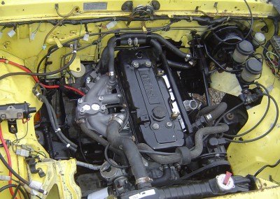

The 1979 4x4 truck I bought had the AC removed & heater disconnected. I'm guessing the heater core was leaking or something, but I'd like to get it reconnected and find out myself.
I've got two hoses coming out of the firewall that aren't connected to anything, & no hoses connected to the heater control valve. I tried scouring pictures online, youtube videos, & the shop manual, but I just can't find out where all the hoses go.
It looks like one goes from the firewall to the control valve, and from what I've seen the other end of the control valve & the other firewall hose run back behind the engine. but where do they go after that? what do they connect to?

Never mind! I found an old post with a pic: Image
Looks the drivers side hose goes to the bottom of the control valve, the control valve goes to the top of the intake manifold, and the other hose in the firewall attaches below the intake. Not sure you'll see this, 3rdLuvNext2a66MALIBU, but your photo sure helped me out!
I also see now that it's my heater control valve that is busted, hopefully that's the only thing wrong and I can find a replacement.
