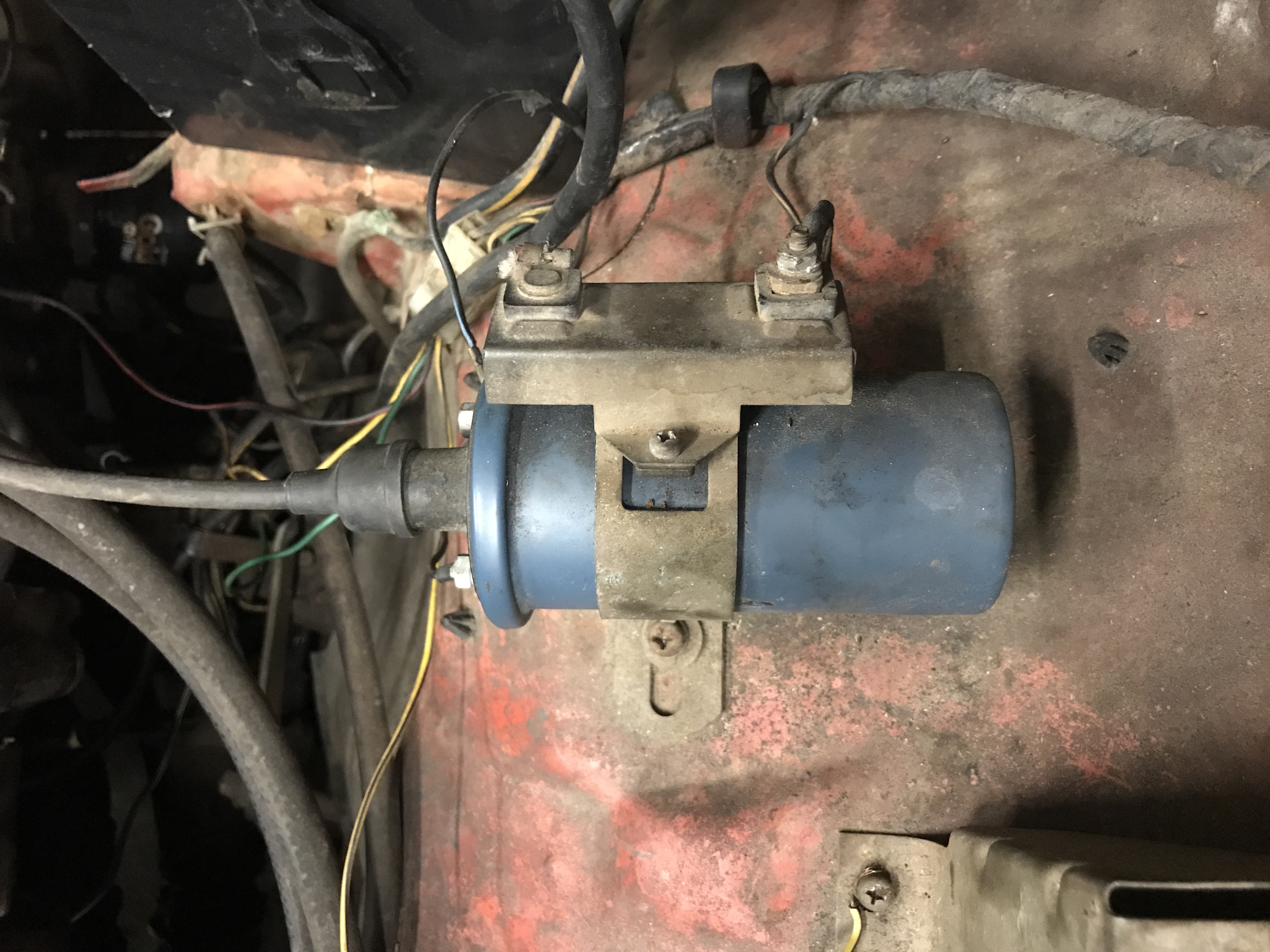

I have fuel and air but no spark. I know the distributor might be bad, but I don’t know how to check it, and there is a blue cylinder connected to the distributor by a spark plug-looking wire, I dont know what it is
File comment: Blue cylinder in question

That is the ignition coil.
These trucks use a points style ignition. Points are a maintenance item and it’s a good place to start looking. Make a note of the orientation of the distributor cap, take it off, and see if the contacts are burned.
Also check the voltage to the positive side of the ignition coil.
