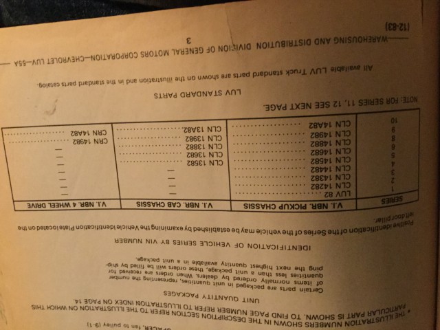

Am about to buy a LUV Truck, need information! I have a VIN and need to know the year of the truck. The seller has had it in a garage for 10 years and the previous owner, his uncle, passed away and left NO paperwork behind.
 Post subject: Re: Newbie!!!
PostPosted: Sun Sep 13, 2020 8:58 pm
Series 1 is a 72. Series 8 jumps to a 78 so no series 7. For some reason my pictures post upside down here.
