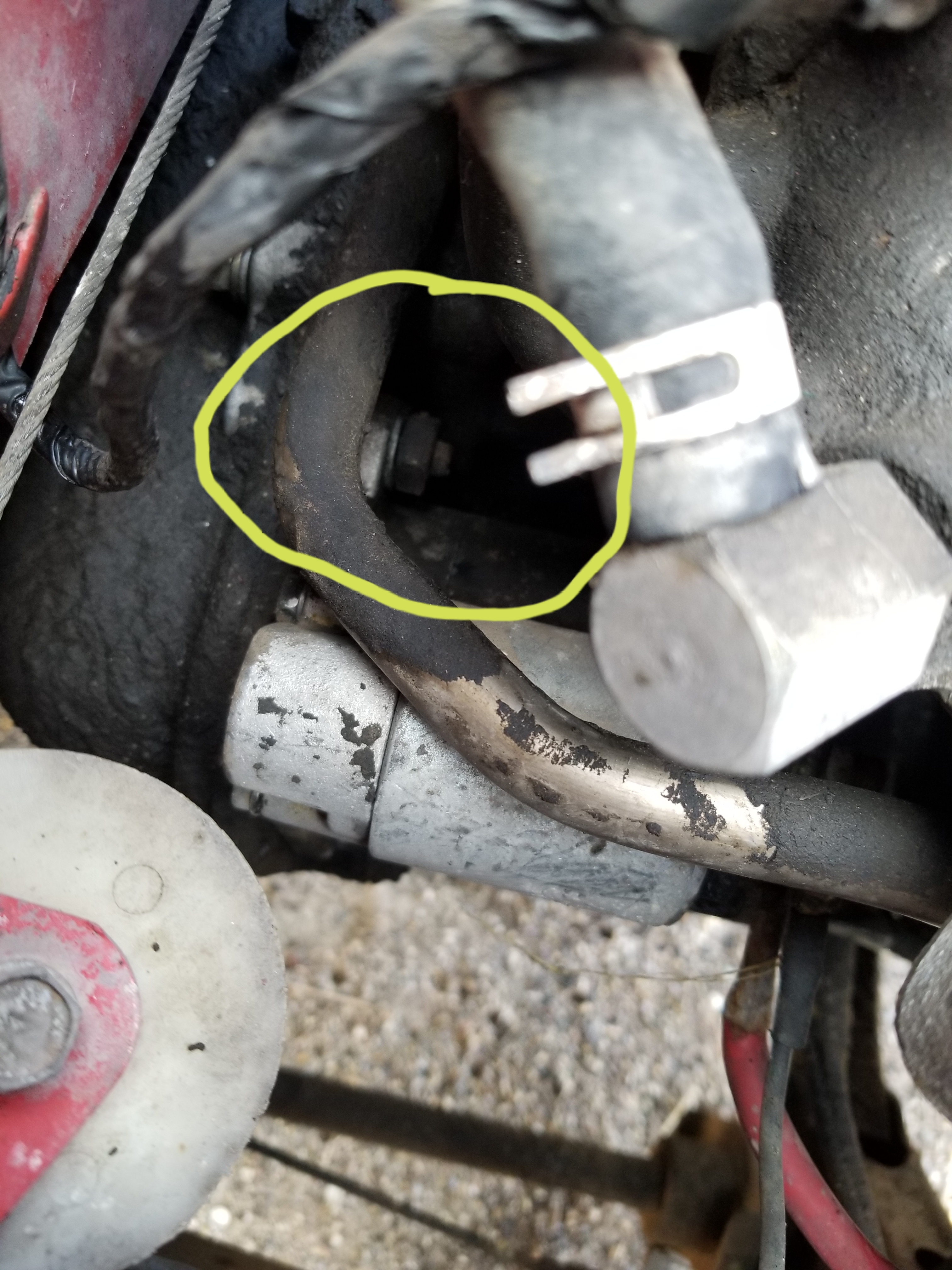

I just acquired 2 1980 chevy luvs. I'm currently working on one of them. I just installed a rebuilt carburetor and got it to turn on. It wont stay on without me stepping on the gas. The other problem I discovered today is that I noticed sparks coming the solenoid area (see pic). Any help would be appreciated. Thanks

If it’s coming from that stud/nut then it’s loose. Also, a ground strap might be missing.

Thanks! Yes. It's coming from that area around that nut. Whoever had it added a ground battery cable but left the other one.

I forgot to mention that it does it when the car is on. Not just when starting. Possibly the same problem? I haven't tried tightening it. I will do that tomorrow and report back on my findings. thanks again

Solved it! Thanks again

so what was the solution to the sparking problem

As luverv8 suggested above, it was a loose bolt on the starter.
