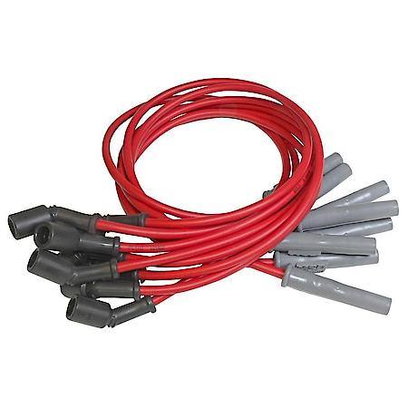

Somehow I don't think you're only getting 6V at the spark plug wires, more like 15,000 volts. My picture is of spark plug wires.
I think what you're talking about is the points wire to the ignition coil. And yes, that should get 6V due to running through the ballast resistor first.
