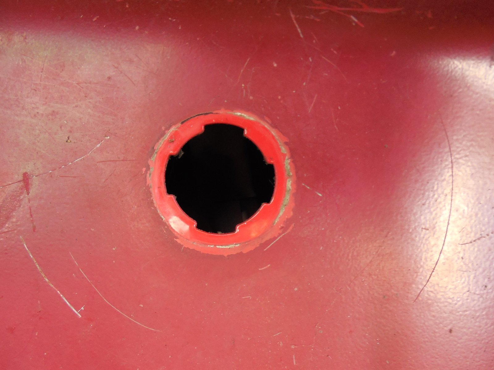

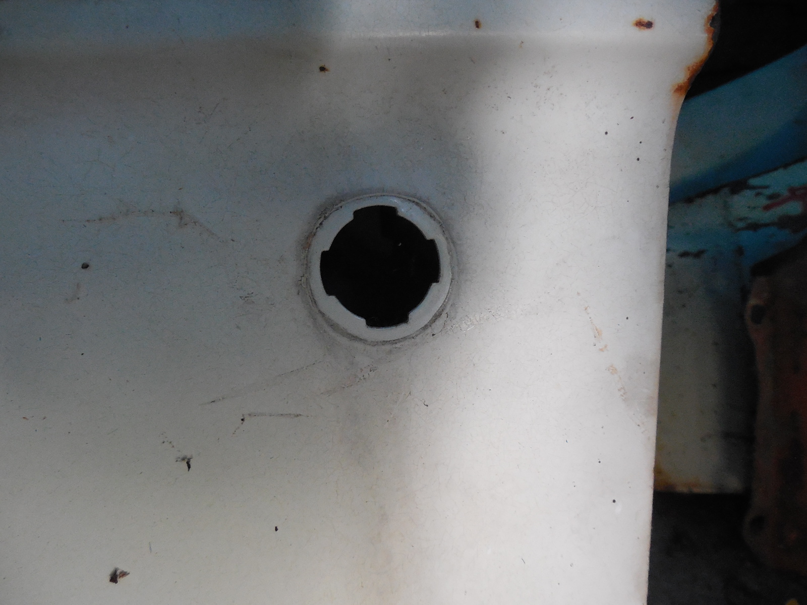

How sure are you them locks are for a Luv ... maybe post up a picture of your parts someone could notice a difference
here's the lock hole on 75 white - 80 red door & my 77 is the same
& PART #'S ON THE EBAY LINK ARE 1 # DIFFERENT IN THE 2 SO I GUESS LEFT /RIGHT LOCKS
