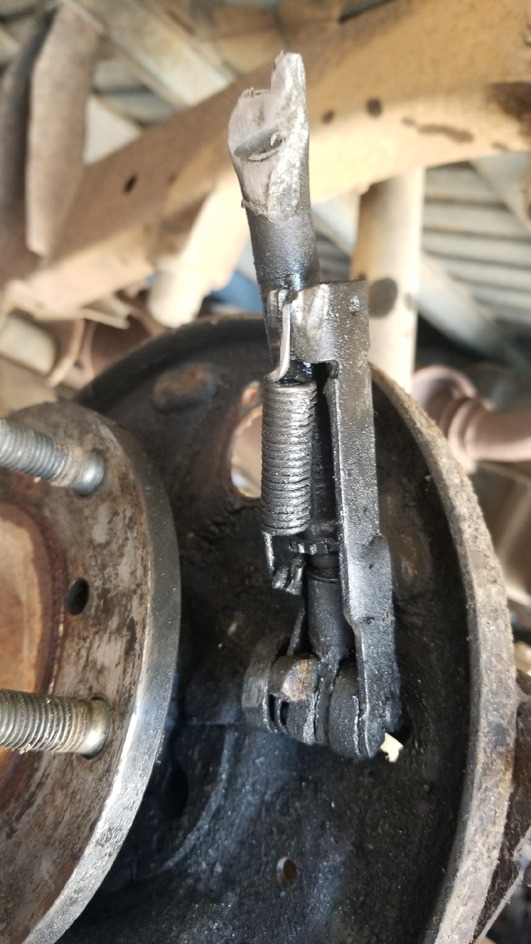

I have a 1981 luv diesel. My parking break hasnt worked since i got the truck, turns out the part that locks in the breaks has broken and scraped the break till one end is flat. I need to know the name of this part and where to find it. It has teeth like a gear on the side that isnt warn off.

It's hard to tell on my phone screen, but it looks like the "brake adjuster" to me.
I'd suggest emailing sqdeb@yahoo.com and ask if they have a good used one from a 1981-1982 model. I believe it changed after 1982 (on the P'up of course, since 1982 was the last year for the LUV). Include your pic in the email.
