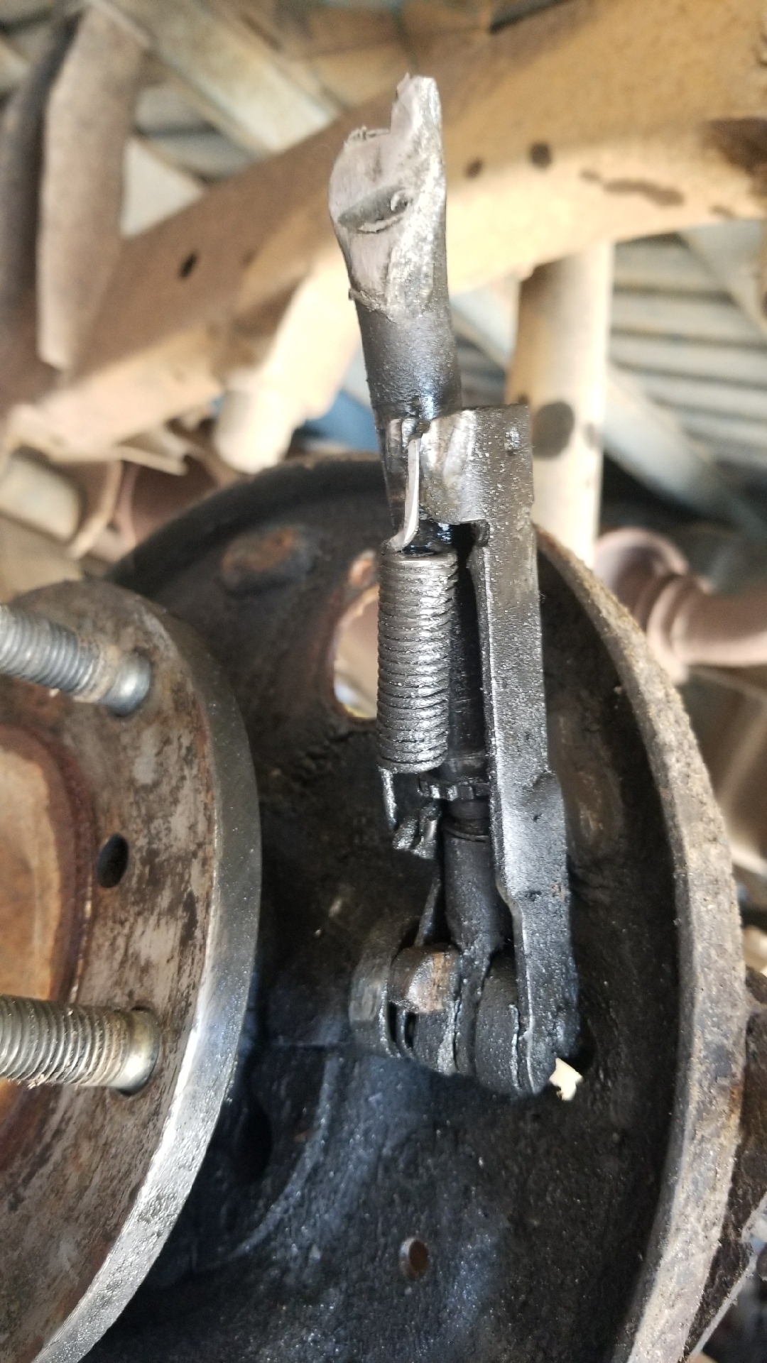

I have a 1981 luv diesel. My parking break hasnt worked since i got the truck, turns out the part that locks in the breaks has broken and scraped the break till one end is flat. I need to know the name of this part and where to find it. It has teeth like a gear on the side that isnt warn off.
Please help me so i can take my flat bottom to the lake and launch my boat.

It's hard to tell on my phone screen, but it looks like the "brake adjuster" to me.
I'd suggest emailing sqdeb@yahoo.com and ask if they have a good used one from a 1981-1982 model. I believe it changed after 1982 (on the P'up of course, since 1982 was the last year for the LUV). Include your pic in the email.
