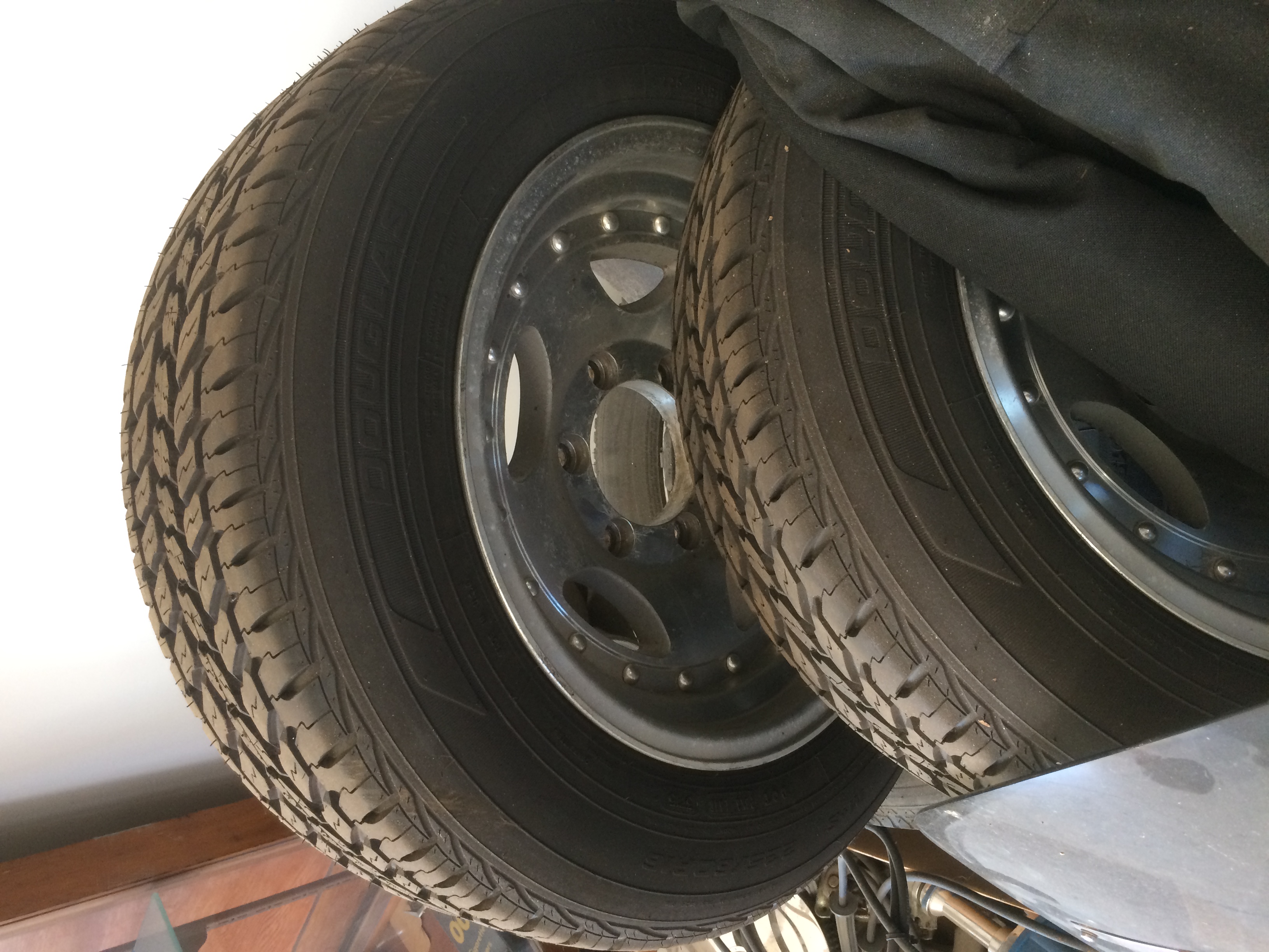

I just bought these for $250. I think they will work. Good price for all four
PostPosted: Thu Jan 17, 2019 11:33 am
Posts: 1702
When buying used tires, always check their year of manufacture. I bought an Amigo and it had a set of zero-mile tires on it, but they were known to be old stock. I bought the Amigo in the Atlanta area and was driving it home to Memphis. I hadn't made it 50 miles when the left rear blew out at 75 mph. I stopped all three lanes of rush-hour traffic coming out of Atlanta on I-85 while trying to get control of it. It finally stopped, still in my original lane -- but looking eye to eye with three lanes of stopped traffic. Their eyes were wide as mine. The guy in my lane applauded and gave me a thumbs-up sign. I had to check my shorts and then limp to the shoulder. :lol:
I ended up not getting them. The tires were not matched and two of them were way to wide. 255x14. Just too wide.
I found those General Tires on Discount Tire web site. Thanks!
