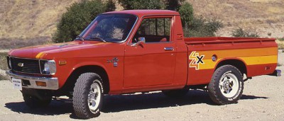

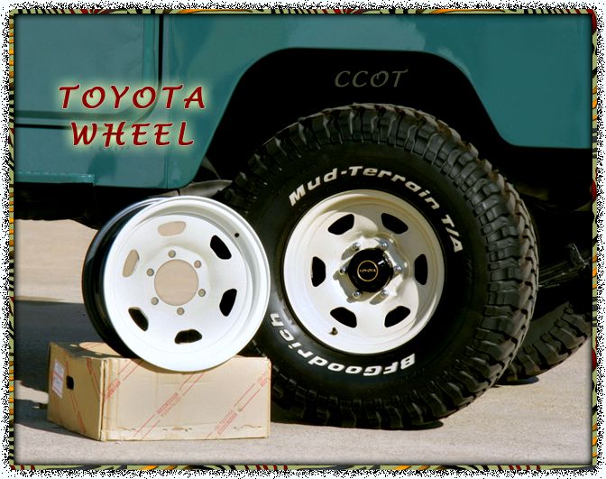

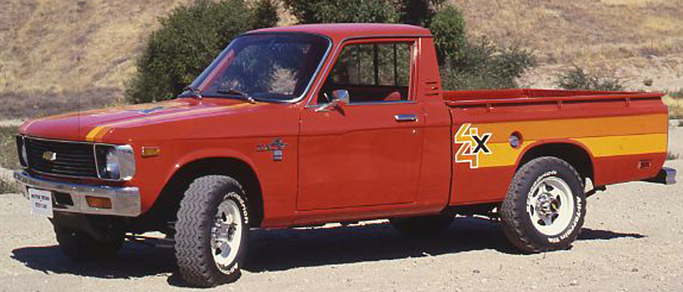

welcome. luvs never came stock with 15's as far as i know.....but after doing a lot of searching there are old toyota fj40 steel wheels that look dang close to the stock luv 4x4 wheels except theyre 15s, same bolt circle too! thinking about getting some for mine??

Very cool, nice find and good idea, assuming the red truck is stock with the 14’s? Is there any problems with running 15’s.?

red truck is stock 14's. There are no problems running 15's, unless un-sprung weight is a concern for you.

I dug around a bit and they are pretty pricey, at least the new / refinished wheel is, they would look good though.

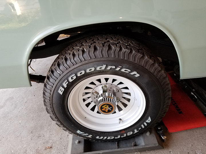

That is a bit spendy for those fj40 wheels :esurprised ....ive seen them for cheaper somewhere...i'll take a look. here's a photo of my wheel and tire set up if it helps. 215 75r15 or 27.5

Very cool, looks awesome! Any other pics of your truck around I can take a peek at?

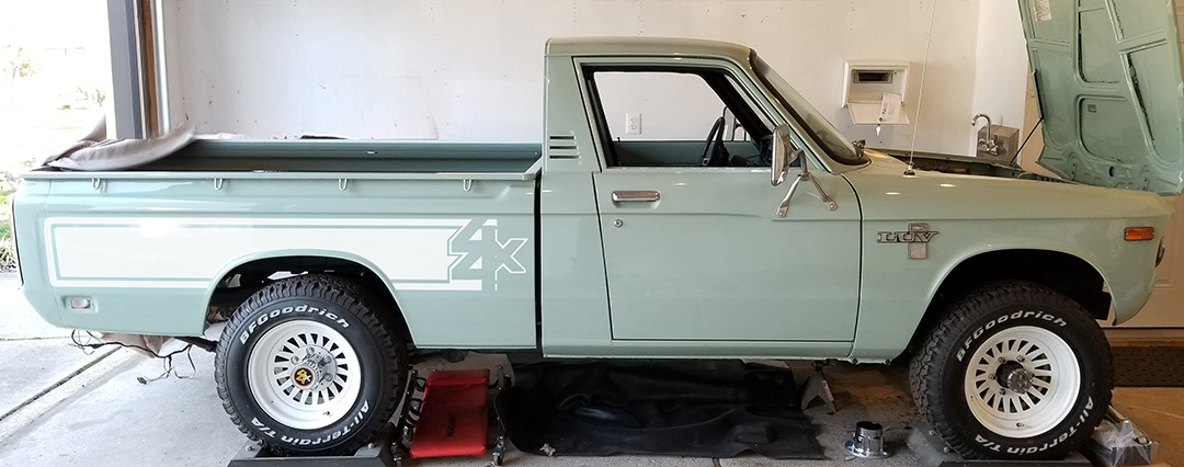

Thanks . heres one as she sits now, in progress...motor is out that's why the front is sitting a tad high.

Nice looking truck! Very cool, are you restoring it? Mostly a stock build? Love the color! I am very new to trucks and LUVs. Have been interested in getting a 60's/70's micro truck and was looking at Datsun, hilux and wound up with a LUV survivor 4x4. Slightly different direction than I had intended.

Thanks. Yea, she's mostly stock. I'm putting a g200 in her in place of the g180. The color isn't stock, I was actually trying to match a Datsun 521/620 color. I'd really like to see some pictures of your LUV survivor!! 8)
