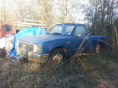

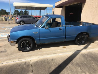

New to the forum. Just give you the run down. I saved an 81 LUV diesel 2wd 5-spees from rotting in a field. After rebuilding most of the front end it is my daily driver. When I bought the LUV, I also got an 85 Pup diesel 5-speed in the deal. Horrible body on the pup but the LUV is "ok". Has rust (or as I like to call it "active weight reduction") on the bed of the LUV pretty bad and the cab corners. The LUV still has all its original glass too. All the glass has Isuzu stamps on it

File comment: How it looks now. I took the bench out and put two captains leather chairs from a 91 Isuzu truck at salvage yard

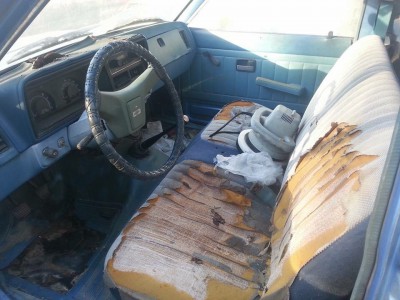

File comment: Interior after I bought it

File comment: How I bought it
