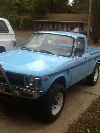

Hello new to the LUV community bought my first one dec 10. I have a 1980 4x4 luv with 1.8 and it still has points.i have been looking around on here where you can buy a 85 trooper distributor to replace points.my question is after new distributor is in what do i hook up? Going to buy new coil but what has to be hooked up and what do i remove from points setup?
