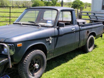

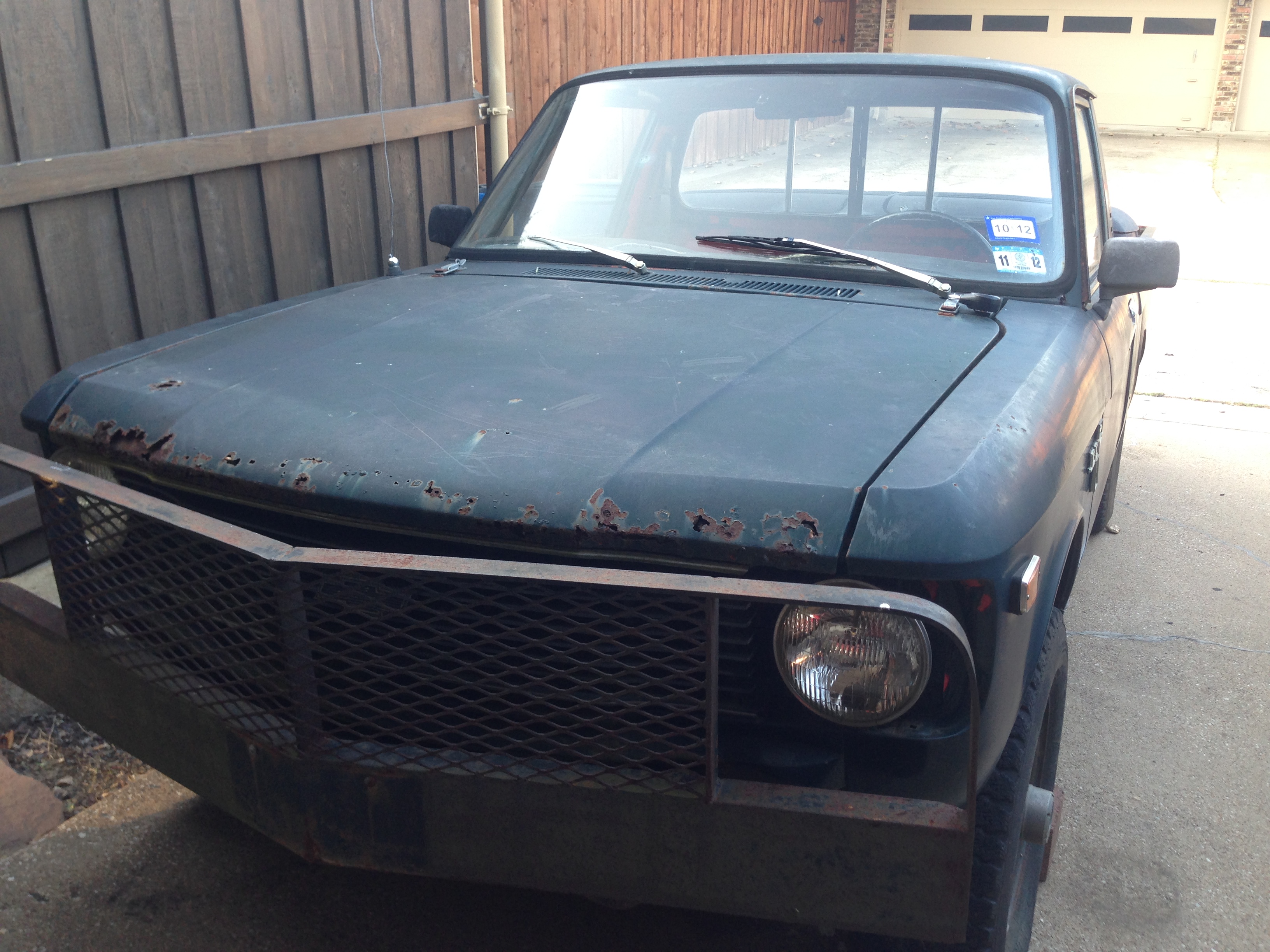

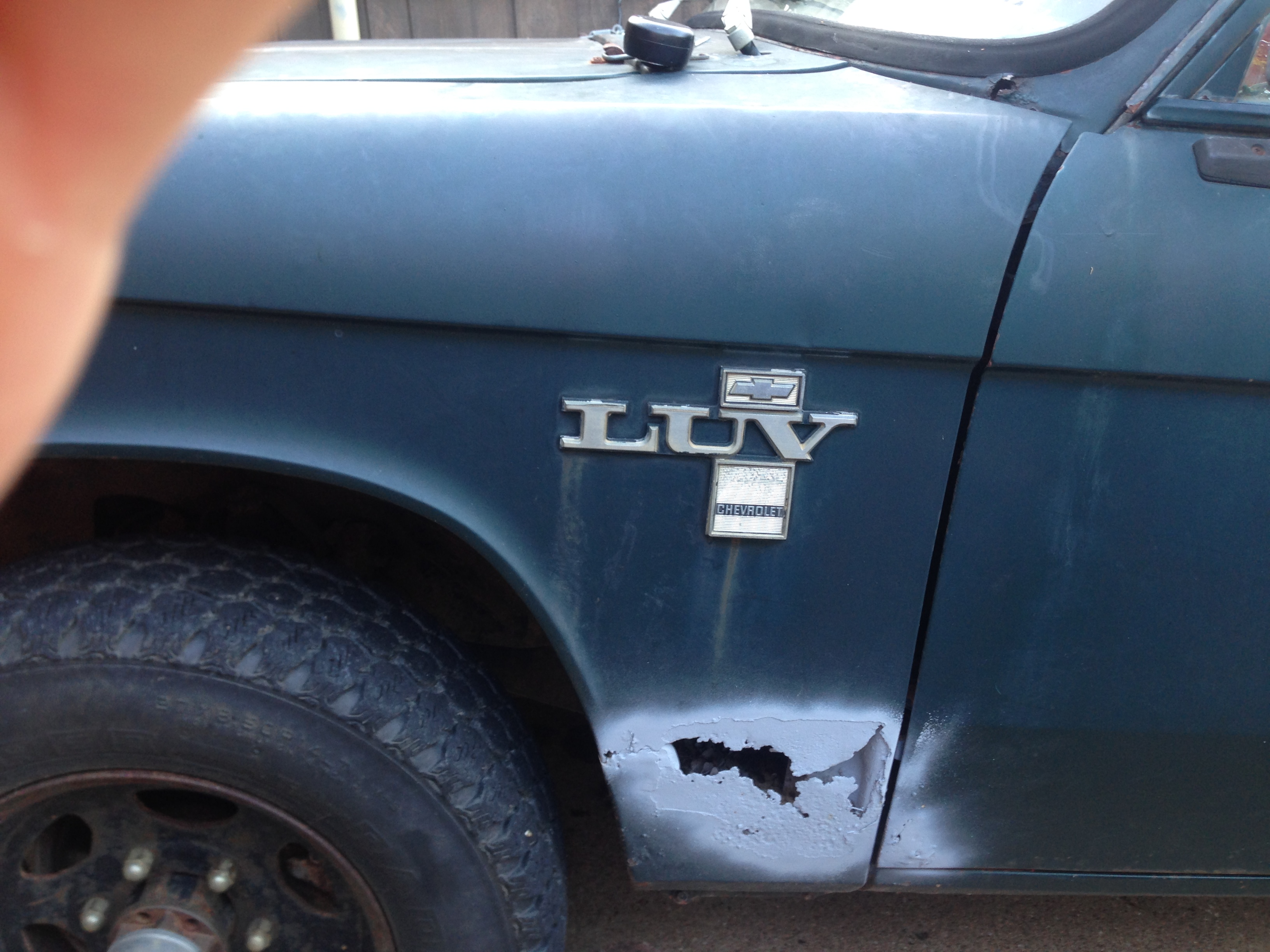

Picked this girl up out in the country and it had been driven on a farm lease. She has 86k original miles and runs and drives. This is my first truck and project so I will try to be the least bothersome I can be, but I'm sure I'll have plenty of questions. So now for the fix it list and pictures:
Needs Fixing:
rust holes
headlights / taillights
horn
chips in windshield
emergency brake
tires
hood latch
door locks
I'm sure the list will grow, but I'm excited to start learning.

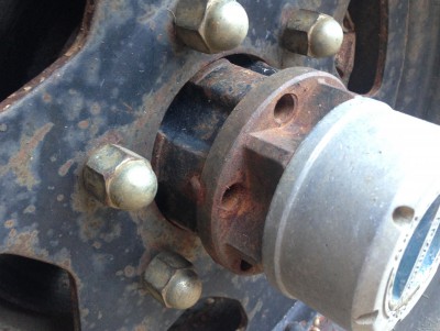

Questions: The front left hub cap has been welded on, any ideas why?

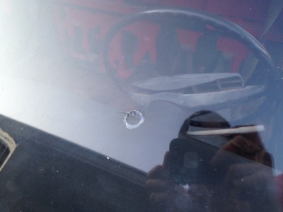

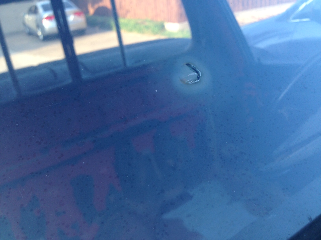

Are these chips in the window repairable, because I'm sure getting glass for it will be a pain?

Here is a picture of the hub and window :

Welcome to the forum! And congrats on your new LUV!
Answers to your questions:
The hub has more than likely been welded on because the bolts that hold them on are fairly difficult to get off and once you strip the head trying to get them off, replacement hardware is difficult to find.
The windshield is not a hard thing to find. Head over to rockauto.com and they will have what you need. However, side glass will have to come from a part-out in the classifieds page.
