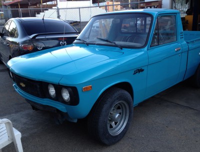

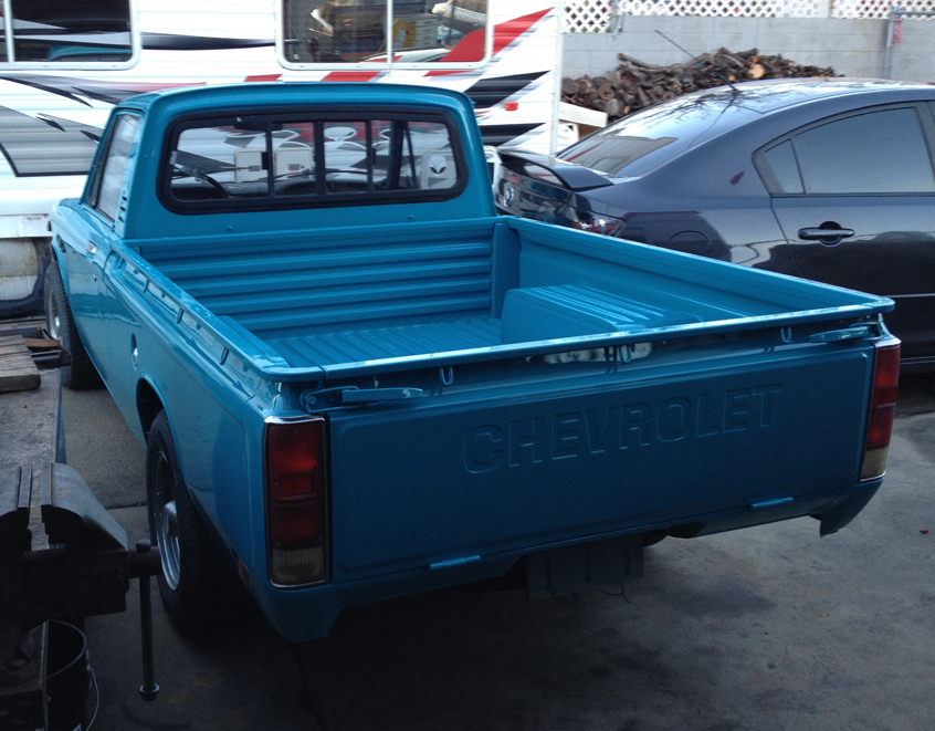

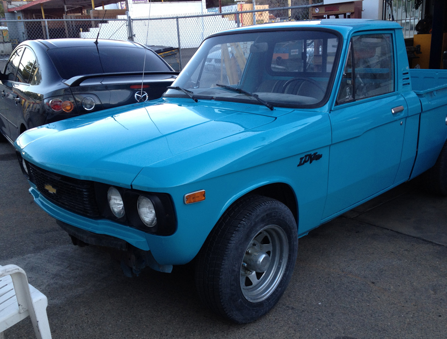

Hello,
I have a 1976 LUV I have owned since 1985. It has been running the majority of the time but sat for a couple years recently. I have been restoring it with the original motor but have run into an issue with the gas tank. I am not mechanically inclined myself so have a mechanic working on it. The tank needs cleaning very badly and I cannot find anyone here in the San Fernando Valley, Los Angeles, who will drop the tank and clean it. They are all afraid they will run into to a situation which will prevent them from putting it back together (parts not available etc).
Does one have to raise the bed to drop the tank?
Anyone with experience in this area who can lend some advice would be appreciated.
The truck runs great but will ruin the carb so this is an obstacle which has become rather frustration.
Maybe I should cut a hole in the tank and flush it then weld it shut, I don't know?
Thanks in advance!
Pics of truck attached.
