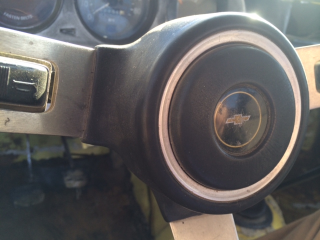

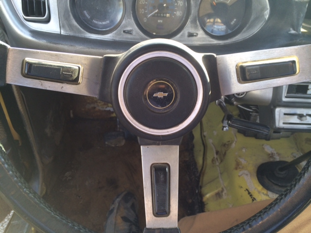

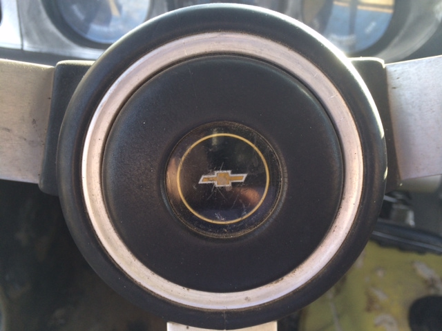

Here are a few photos I took of my 1978 Mikado steering wheel today. I am assuming the steering wheel is actually the original, but the truck is new to me so I cannot guarantee that fact. Hope this helps.

Many thanks Robert, that does help, it show how far it sits forward of the silver trim ring. :D
Can you tell me is that vinyl ring padded or hard?
I am hoping someone has a picture of it apart. :eugeek

The vinyl surround is fairly hard - feels sort of like a hard rubber. I can just slightly dent it with my fingernail. Whether it was that hard in 1978 might be another question ;-)

Thanks again Robert, I think I can make a fairly good copy from that info :D
