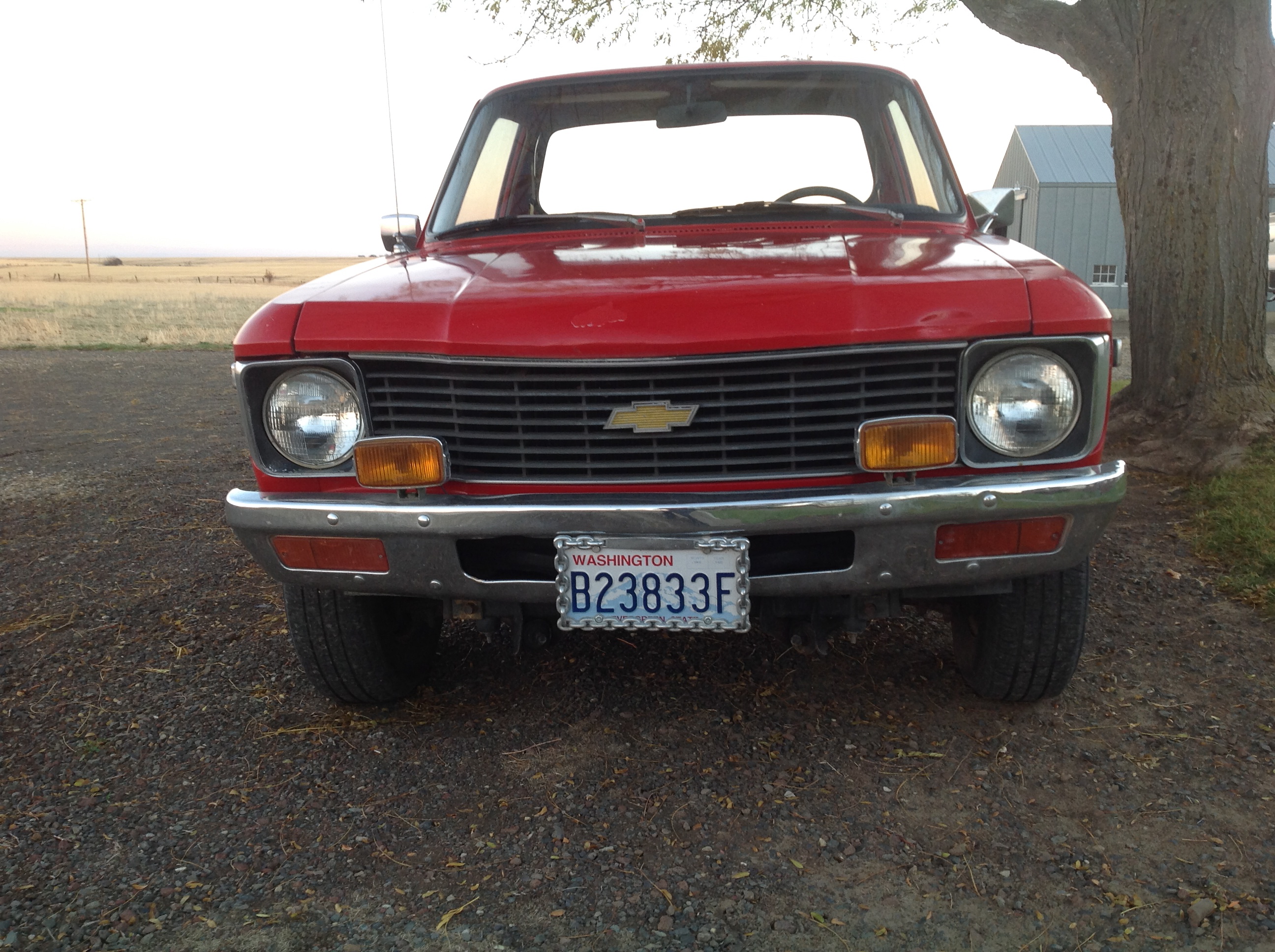

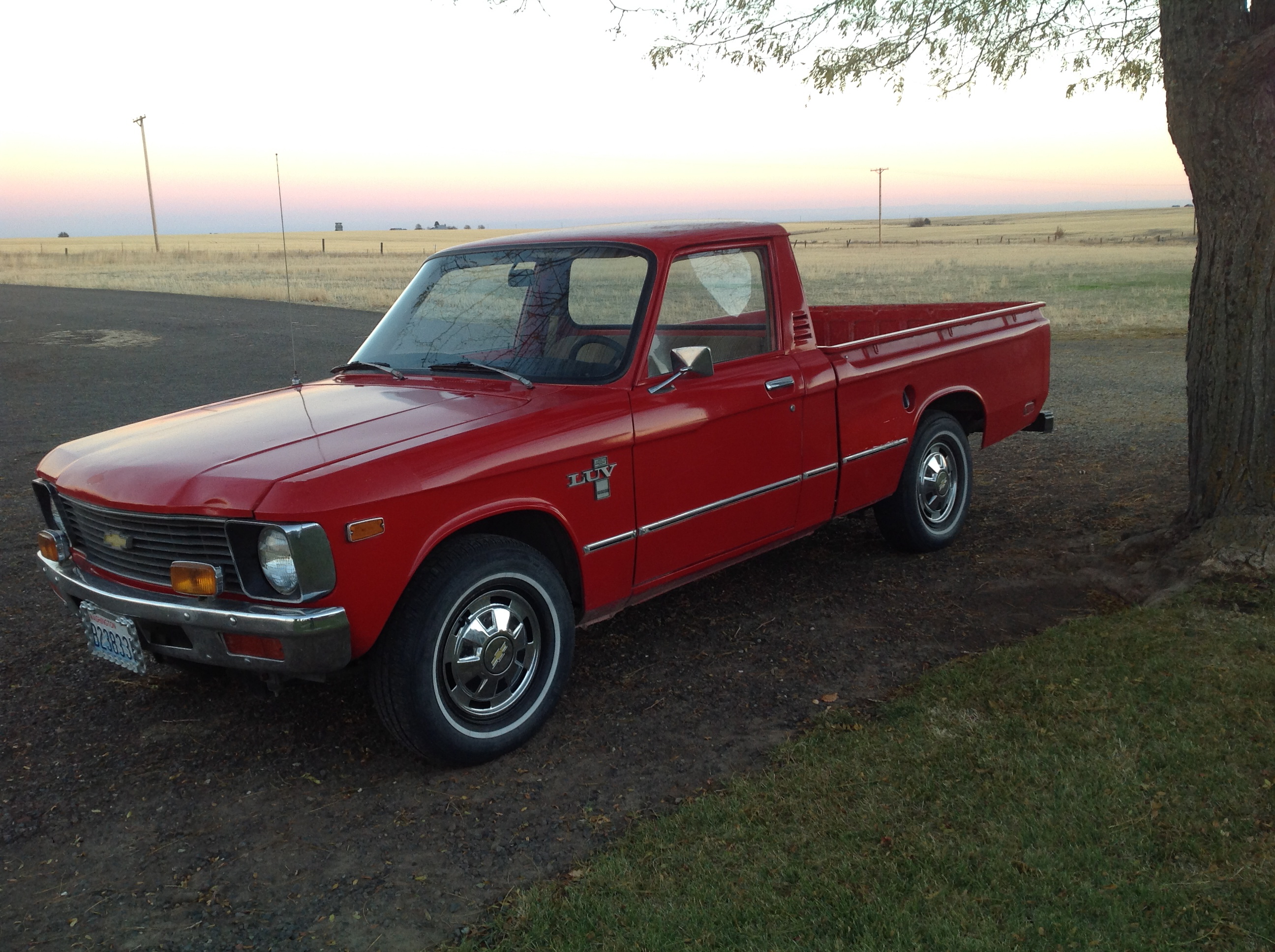

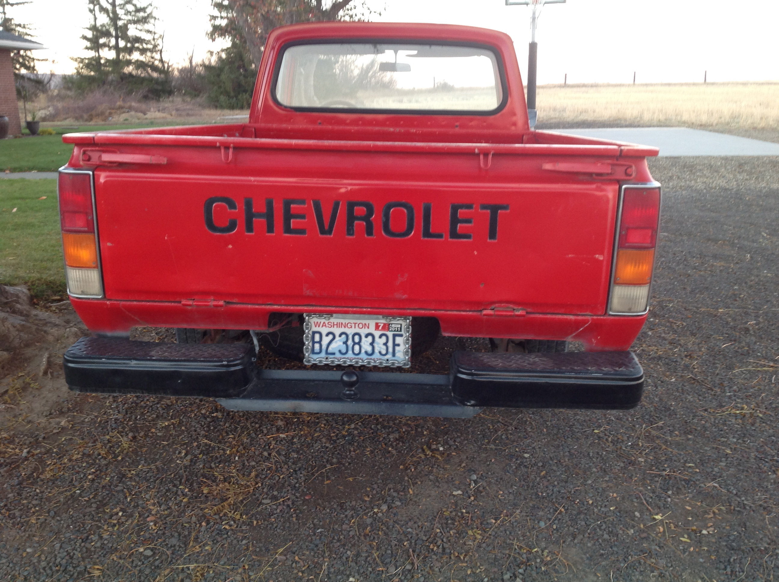

guy wants 1k says it runs good "if i had to drive it to NYC tomorrow i would" (good sales pitch :P)
1979
anything i should look out for when i go check it out tomorrow?
thanks for helping me (newbieeee)

Looks pretty dang clean for 1000 bucks. Almost too good to be true, actually. Is the interior gone or something? From what he says, it runs well, but do you have any pics of the engine bay?
Is there any rust in the floorpans? Wheel wells? Frame??
Based on those 3 images you posted, I'd say it's worth a thousand dollar gamble
edit: feel free to sell me your rear bumper when you buy the truck.

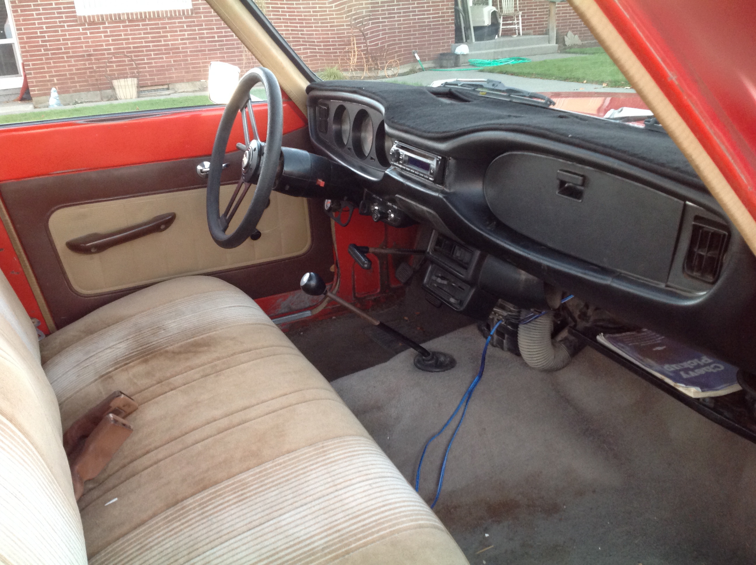

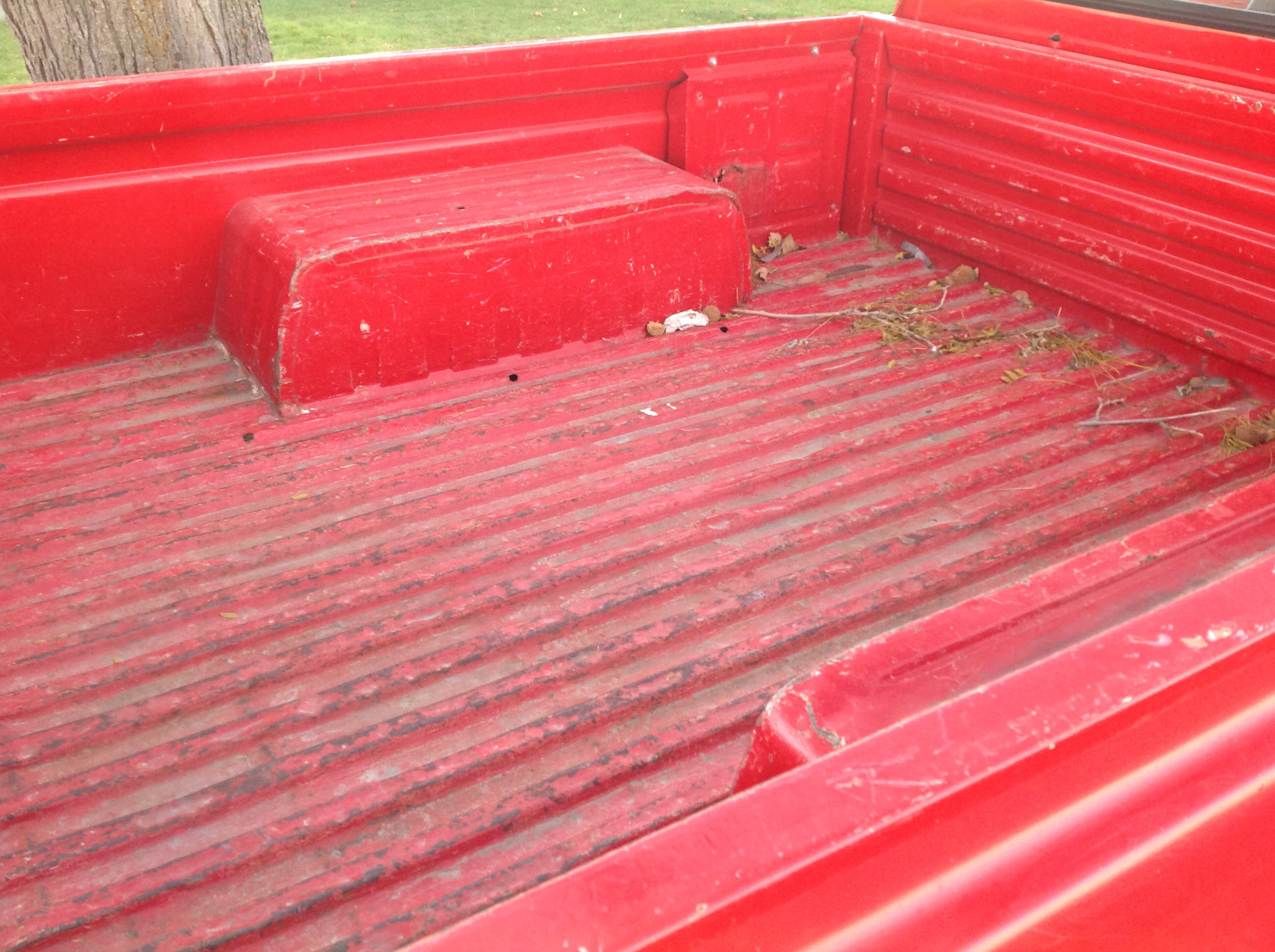

no pics of the engine.. here are the only other 2 pics i got...
it come with an extra hood... and somthing else... if its the bumper ill hit you up!

The license tags say 2011 so hopefully the pictures are current. In California back due registration can kill a deal pretty quick. If it looks like that and runs it is a good deal. Lift up the carpet and check the floors though. 8)
 Post subject: Re: good deal?
PostPosted: Thu Oct 31, 2013 8:56 pm
Check the rocker panels under the door for rust.
