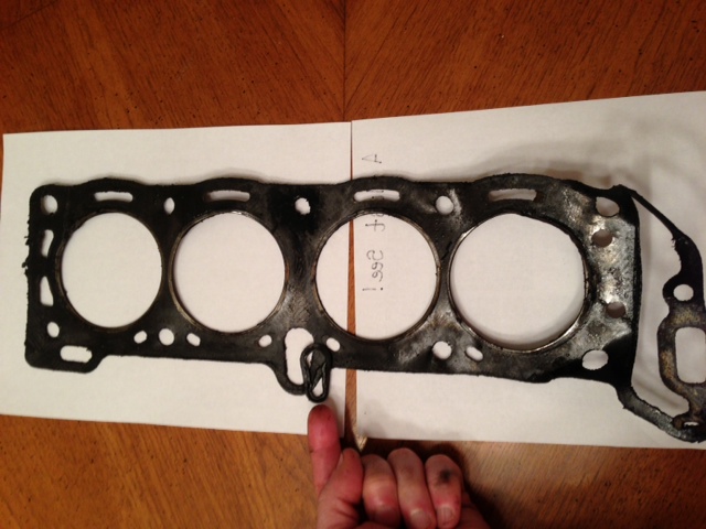

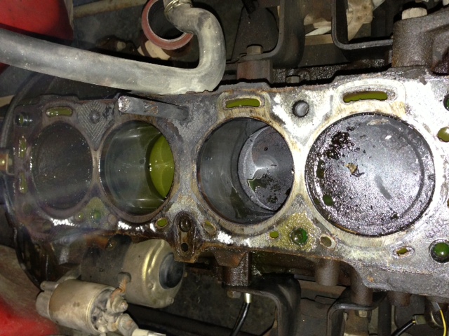

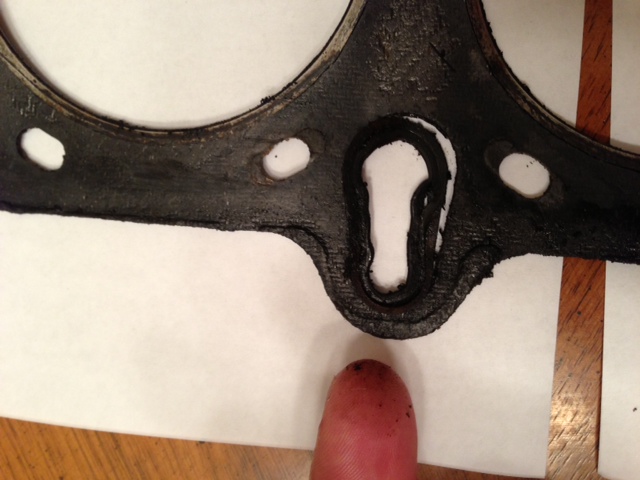

Update - I got the head off and inspected everything. It appears to me that the problem was a small, removable piece of the head gasket, which surrounded one of the head bolts. This piece had become partially loose, so that there was a gap between it and the rest of the gasket. This is precisely where the leak occurred, so it seems logical that this was the source of the leak. I did not see any cracks in the block or head, or any other problems with the gasket. Other than that, everything seemed to be in good shape. This seems like kind of a flimsy gasket design, creating a potential weak spot.
Am I right to think this was the source of the leak? Should I just replace the gasket and see if that solves the problem, or should I do other things as well while I have it apart? Should I have a mechanic inspect the head? I put a straight edge on it and it seemed even and level.
Any trick to replacing the head gasket? There's a little residue left on the block after removing the gasket, does that need to be perfectly clean? Any cleaning tips?
It appears as if oil and coolant were mixed....should I do something to address that while I've got it apart? Does the system need to be flushed?
I've attached pictures.....my finger is pointing to the loose spot on the gasket. I've also attached a picture of the block.
Sorry for so many questions....this is my first time! Any feedback is appreciated.
Thanks.

Yes that is where the leak would be. That is an oil passage where the oil comes up and goes to the head to lubricate the cam bearings, and valve assembly. Of course clean the head and block surfaces thuroughly removing all traces of old gasket material, etc.
Yes it looks to be a simple gasket failure in that area. I always used FelPro brand gaskets, as they seemed to be of the best quality at that time at least, 80-90's. They had a band of blue rtv sealer around all the water port areas.
Also another hint: place a dab of sealer under the head gasket in the tiny crack where the block joins the front timing chain cover, just a tiny dab with your finger. Will stop a sometimes very small oily leak in that area.

Thank you! Am I okay just replacing the head gasket or should I replace the exhaust and intake gaskets while I'm at it? Could that be done later without pulling the head?
What's the best thing to use to clean the surfaces?

Scrape the block and head surface with something like a single edge razor blade- you can't get them too clean- then wipe with a rag soaked in brake cleaner or the like. Stuff the bores with rags to keep scrapings out, blow out with compressed air if possible. Don't leave oil or water in the head bolt holes in the block, blow out with compressed air if you have it. Put the head gasket on dry, no sealant except for the slight smear (read thin) at the block to timing cover juncture as described.
You probably need to change oil before starting since the coolant residue in the head made it's way to the bores (and probably past the rings into the crankcase). You did drain the radiator before starting the head removal, right? So new coolant as well, 1 gallon into an empty system, then fill with water makes it just a bit over 50/50. Soak up all the coolant you can with paper towels or rags or use compressed air, you don't want any getting on the sealing surface.
If the intake & exhaust gaskets are not leaking leave them alone.
I don't see where you have sourced the coolant leak, check the heater hose that connects to bottom of the intake before you re-install a soft or split hose- go through the fender well to re-connect this, you can maybe see it instead of doing it by feel. Same if you ever have to R&R the intake gasket or a starter.
The two little hex bolts that go through the front of the head into the timing cover are not head bolts & only torque to about 14 ft-lbs (or just good and snug). If you drop one into the timing cover you have to lower the oil pan to retrieve them, so put the rag back around the chain before trying to install the bolts.

One more question - as you can see in the picture of the block, there is still one head bolt in there. It was stuck, and it stripped when I tried to remove it. I drilled out the bolt head to get the head off. Now that I've got a lot more room to work to try to get it out, I've used penetrating oil and locking pliers to try thread the bolt out, to no avail. Should I just persist with the penetrating oil and pliers, or does anyone have any other suggestions?

I would continue to use the locking pliers (vice grip) and soak it with penetrating spray (Gumout) about every time you walk by it. Best stuff I have ever used is Gumout Carburator cleaner spray. It seams to just eat corrosion and will come out after you work it back and forth with the vice grip pliers. A small pipe wrench may also get it if the pliers doesn't get it.

Look the gasket over very carefully at the coolant passages, if it was a head gasket leaking coolant there will be evidence of coolant travelling from one of the passages to the exterior of the head, the area that is damaged is an oil passageway (hence the oil leak) but you said the coolant wasn't leaking into the oil but onto the ground. A coolant leak to the outside generally will leave leak stains, look for them where they would run down the head or block, look the intake manifold, water pump & radiator over very carefully & all the rubber coolant and heater hoses. As I said before it would be highly unlikely for the head gasket to leak both oil & coolant at the same time without the two mixing, but if it happened there should be obvious evidence of separate leaks at an oil passage and a coolant passage.
The broken head bolt must come out, whatever works. You may have to get someone to weld a nut to the stub end, cover the rest of the engine first, welding slag in the engine is not good. I'm surprised it isn't easy to unthread with the head removed, all the pressure holding it tight is the bolt head against the cylinder head- unless someone put thread locker on it. Head bolts need to me lightly oiled, no sealant, & the holes clean. You're going to need at least one head bolt, check the others, if the socket head is not crisp or you are concerned it may round in the future replace also.

I have had to do the same with that same head bolt more than one. It is sandwiched between the #2 and #3 exhaust ports and heat near welds it in place making it very hard to get out with the head on. Once the pressure from the head is off though, it came out with relative ease. I used a large pipe wrench on the last one I did, just take care not to drop the wrench onto the top of the block and scratch or dent it. The other time I've done this the bolt came out quite easy with vice grips.
Also give that bolt several good smacks from the side with a hammer. That will help break loose its grip on the block.
Failing that, welding a nut over the top can work, or grinding two sides flat and using a big crescent wrench on it can work too.
