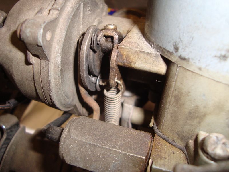

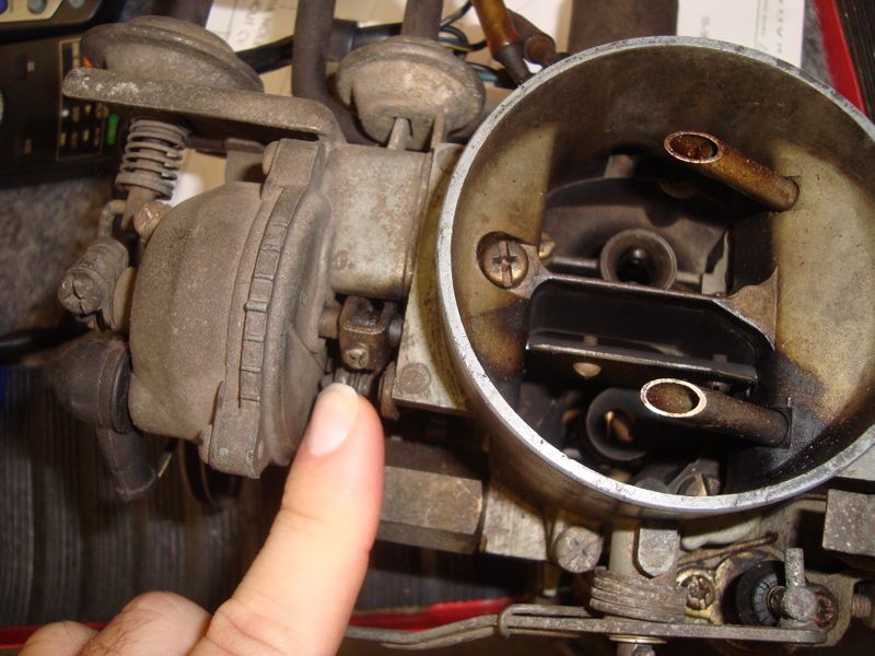

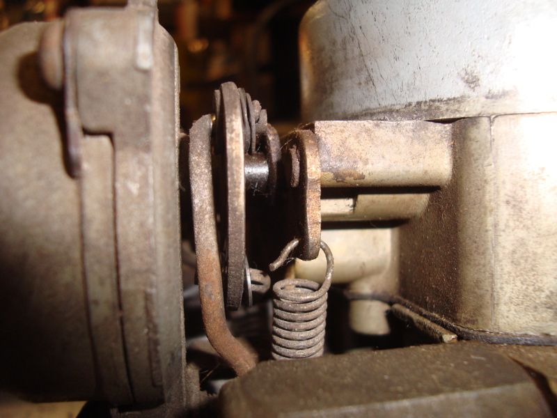

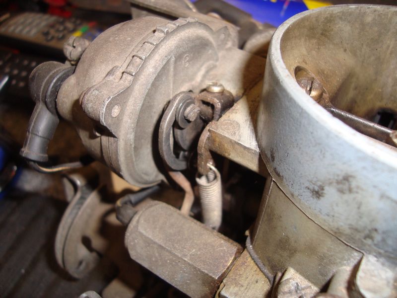

I would suspect the auto choke is bad or on wrong. Could also be the linkage. Here's some pics of a working carb. I can easily push down on the linkage and the choke will open fully.
Hope these help.
