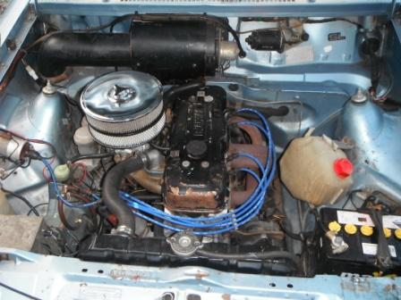

As you may know we have a Holden built Gemini which share the G Series Isuzu engines with you guys. These date from 1975 (TX) thru to 1984 (TG).
Basically I am keen to source a supply of New cylinder heads and require shipping to Australia. Our suppliers closed years ago and trying to find a good used cylinder head is getting very difficult. Most of ours are corroded beyond repair.
Q) Are there any Brand New G180z heads available in the USA, and if so could you please point me to a web address that may have some on the shelf?

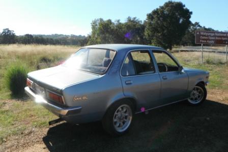

Any information would be much appreciated, I just want to keep my '79 TD Holden Gemini on the road for years to come.
Cheers from Oz , Leo
File comment: with extractors and 32/36 weber,

File comment: heres a pic of my ride

What series engine is it? You mentioned it's a '79 car, but I don't know if the Gemini and LUV engines were consistent with eachother year-by-year. On the LUV, the intake ports flipped to the RH side in 1977, and the situation of the timing chain run-through changed a bit. I believe the head changed again at some point between '77 and '80, but someone here will correct me if I am wrong.

It is a G Series. G180z. our Geminis all have the same head from 75-83, the only changes were anti pollution/smog which we just block off with bolts. or mechanical and electronic fuel pump which again can be drilled out/ blocked to suit.
The engines also came in 1.6 L 1.8 L and 2 L which are all interchangeable with Isuzu blocks. With the 2L head the water jackets dont line up as well but are able to be modified to suit.
I bought a KB25 ute , it came with a 5 speed, 1.8 L Isuzu engine, which is exactly the same as what i am chasing. unfortunately the head was warped and corroded.
