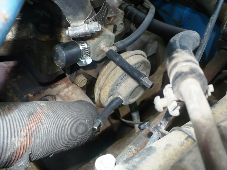

Could be your EGR valve malfunctioning, Id check it.

I took a look at my EGR valve, someone capped it off, I don't know where the hose should be going.
