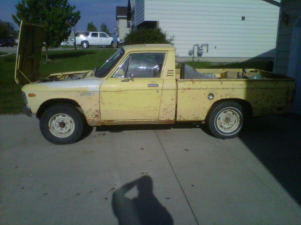

I have always wanted a LUV of my own since I was a Kid. Learned to drive on my grandfathers 76. Got my chance and picked one up for $300. But any ways, the truck has quite a bit of surface rust and I dont have the money right now to get a new paint job on it. Any suggestions? I thought about just grinding down the rusty spots and spray painting the entire truck with a flat black rust inhibitor. Im only 23 and have never really done this type of thing but I want to learn. Any suggestions would be greatly appreciated!!

This is a very wide open subject...to much to answer in detail here. Forget the word GRIND unless you are grinding out a section to replace. I have painted alot of vehicles and my best advice I can think to give you is....if you're going to do this yourself (and there is no reason why you shouldn't as long as you don't expect it to look absolutely perfect) is to find some online video's or rent some. Take a look at Horsepowertv.com and also EASTWOOD.com. If this is your first project of this magnitude don't expect miracles of yourself.

sand it down to bare metal starting with 80 grit and working up to 220 or go from 80 to 220 primer it with auto spraypaint primer. and after it dries clean with a dry rag check for oil spots silicone marks that the paint wont stick too get rid of them easy by sanding everything to bare metal. and paint it hot rod flat black. boom shakalocka

Looks like a pretty decent truck to start with. If I can take this truck...
And turn it into this...
With just lots of sanding, a little bondo, some spot putty and using Rustoleum rattle can primer and spray paint, then you should be able to as well. I didn't sand it all to bare metal, just the rust spots, but it took lots of time to fill those spots back in. It probably would have been less time consuming to just take it all down to bare metal. I didn't put that much thought into it though until after I started it. It isn't a pro done perfect job, and I have put tons of hours into it, but it still looks way better than what I started with! The truck sat in a barn for 7 years and the birds did a number on it. I have had it for 7 years and haven't really worked on it in about 3 years. I just have to finish color sanding and polishing and do some touch up painting. If I ever get back to it there surely will be pics to come. I originally was only going to primer it or use flat black. Then I decided to paint it too while everything was torn apart. Then I figured I might as well start color sanding to make it look even better. Probably anything you do will improve what you have. Good luck with the truck and welcome to the site!

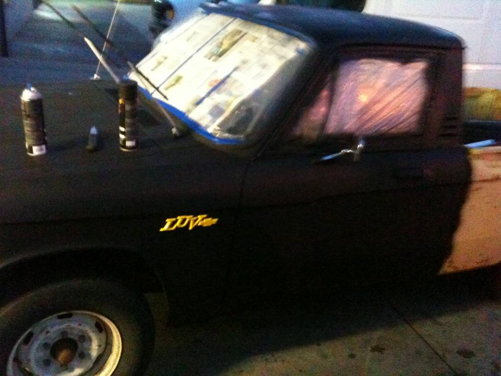

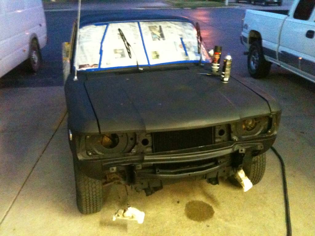

What Ive done so far. Dosnt look perfect but it looks a lot better than the rust yellow it was before.

and another pic

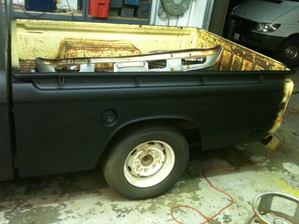

Still have to paint the truck bed them ill be done!
