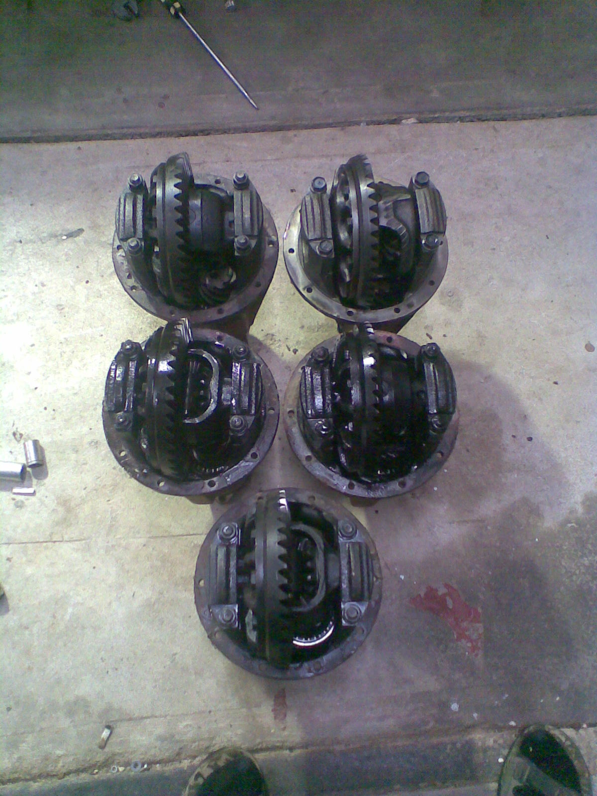

Front diff is commonly known as an 8bolt and rear is a 10bolt, ratio will be 4.555:1 (Australian Spec Luv/KB Isuzu)
http://adelaide.gumtree.com.au/c-Cars-V ... Z222567016
File comment: Rear Diffs
File comment: Front Diff Disassembled

Diff centre looks identical to ones used in Mitsubishi L200 and Scorpion.
