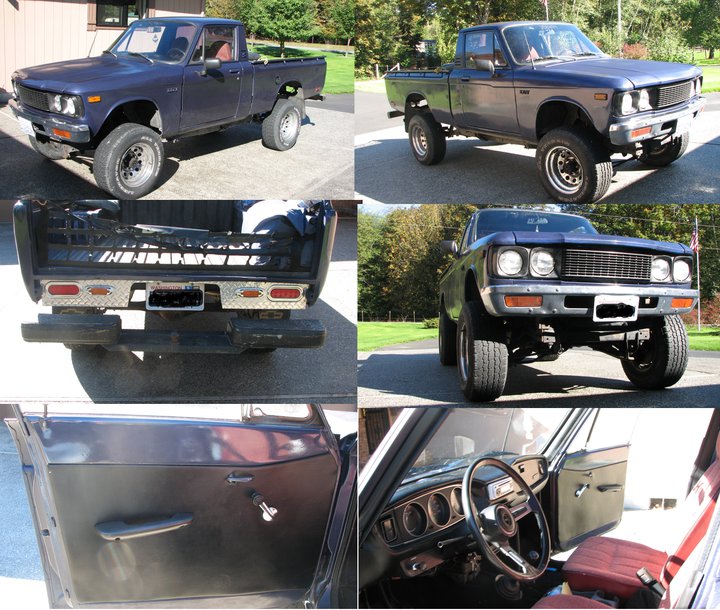

Here is the most recent pics. I have seat covers now and the door handle beauty rings.
