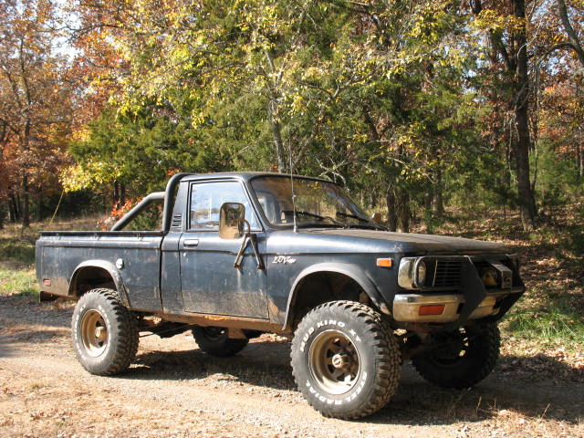

You can attach pictures directly to your post/reply from a computer, don't know if you can from a phone though. Your pictures are size-limited & if you attach more than one the latest one you attach appears at the top. See the "upload attachment" box near the bottom.
File comment: Example, my truck in '08
