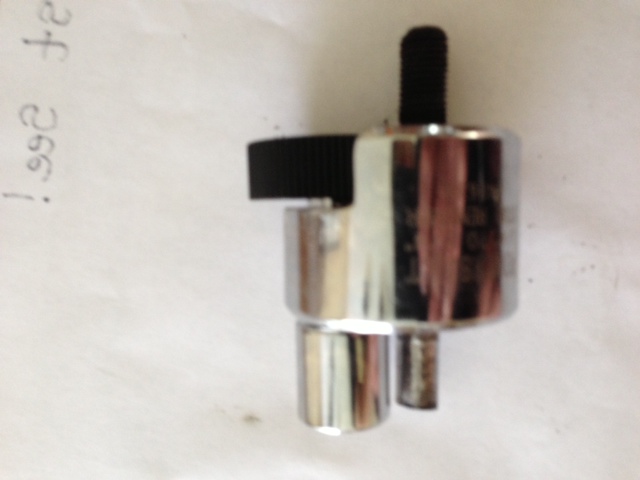

Update.....here we go.....I've got the new head gasket and I'm gonna try to put everything back together today. One thing I thought I'd share - I couldn't get the head bolt out despite repeated doses of penetrating oil and multiple tries with the vice grips. It wouldn't budge. So I bought the attached stud extractor on Amazon for $13 and the bolt came right out. Couldn't have been easier.
More to come.....thanks again for all the tips!
