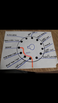

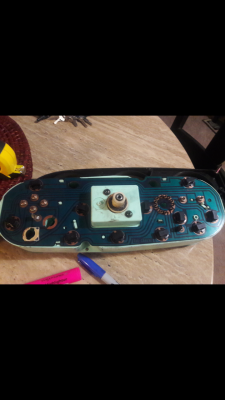

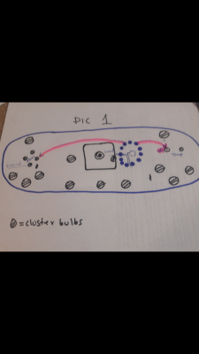

1980 luv 2wd cluster wiring diagram

Thank you so much for posting this! Saved me a BUTTLOAD of time chasing the ground circuit. I am changing over to LED bulbs while I have my gauge cluster out and needed to know which way to put the bulbs in. Now I know for sure for proper polarity! :D
