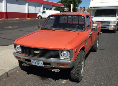

Well no thanks photobucket, let's try again, one is attached, the other is a link to an animated gif I made at the end of the 128 mile trip.
https://media.giphy.com/media/26n6NKpg5 ... /giphy.gif
