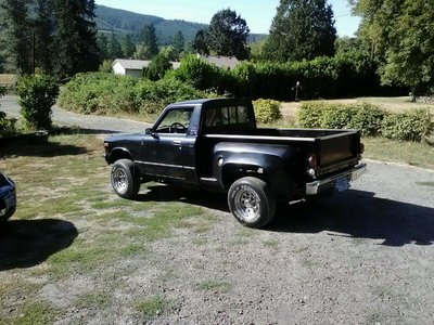

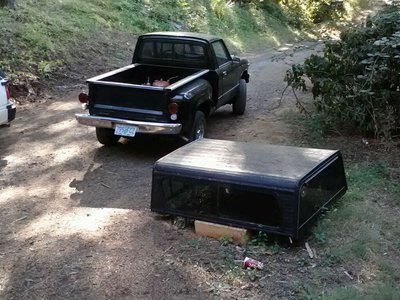

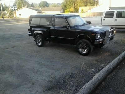

Here's a few pics of my luv

Good looking truck!
