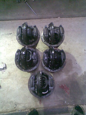

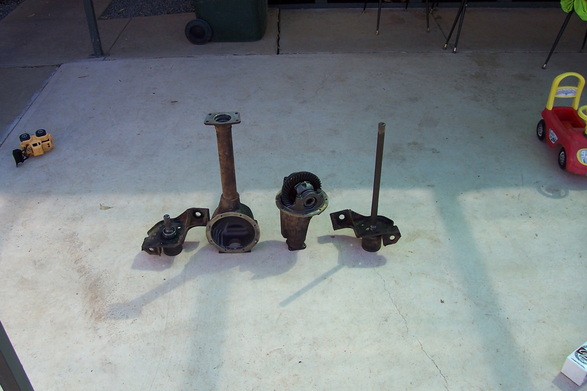

Front diff is commonly known as an 8bolt and rear is a 10bolt, ratio will be 4.555:1 (Australian Spec Luv/KB Isuzu)

File comment: Rear Diffs
File comment: Front Diff Disassembled
