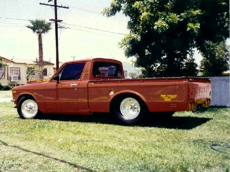

12.I really like this red one, so I think I'm going to want this year, what year is it?

12.I really like this red one, so I think I'm going to want this year, what year is it? that looks like a 72 or 73. It still has the round taillights under the tail gate.
