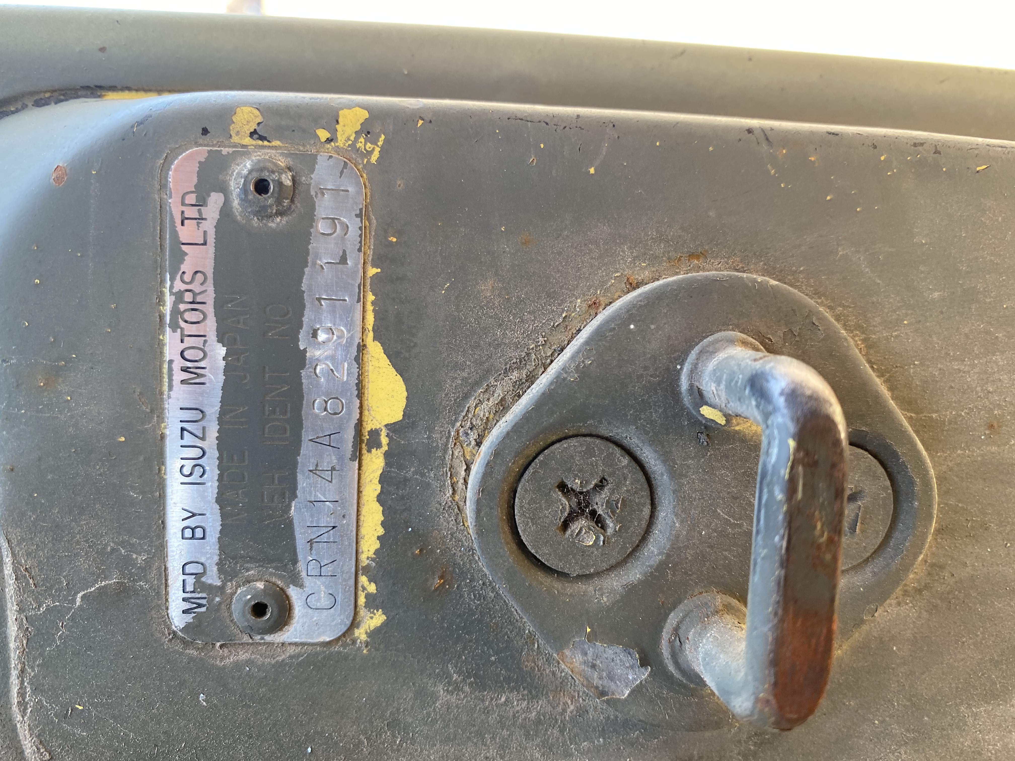

All I know from the auction is that it’s a 1971 Chevy LUV form the post but the certificate to obtain title has everything wrong. I’ve been buying parts as 1972 Chevy LUV. I’ll add a picture of what I’m having trouble with.

It might be helpful for you to check the LUVTruck.com main menu Information tab, then the Miscellaneous area and then under that go to the History of Chevrolet LUV. I have used this often and found it informative as to what transpired on the LUV trucks. If you check this out, you will see according to the info, 1972 was the first year for the Chevy LUV.
If the original box is still on the pickup, it should have round taillights to be a 1972, however maybe the box has been changed.
As for the serial number you shared in the photo, according to the GM Series 1 thru 11 LUV Truck Parts and Illustration Catalog, your serial number is noted to be for a 1980 4-wheel drive. There is another place you might also find the S/N and that is on the firewall of the cab in the engine bay; it is more to the passenger side, (if this is a left-hand drive), below the cowl panel and above the emergency brake pulley area.

I believe you're looking at 2 different VINs. The early LUVs VIN did start with LUV. Later, the had the CRN. LUVs started in the USA as a 72, so you don't have a 71. Does it have a bed on it? What do the tail lights look like and where are they located. 4 headlights or 2?
