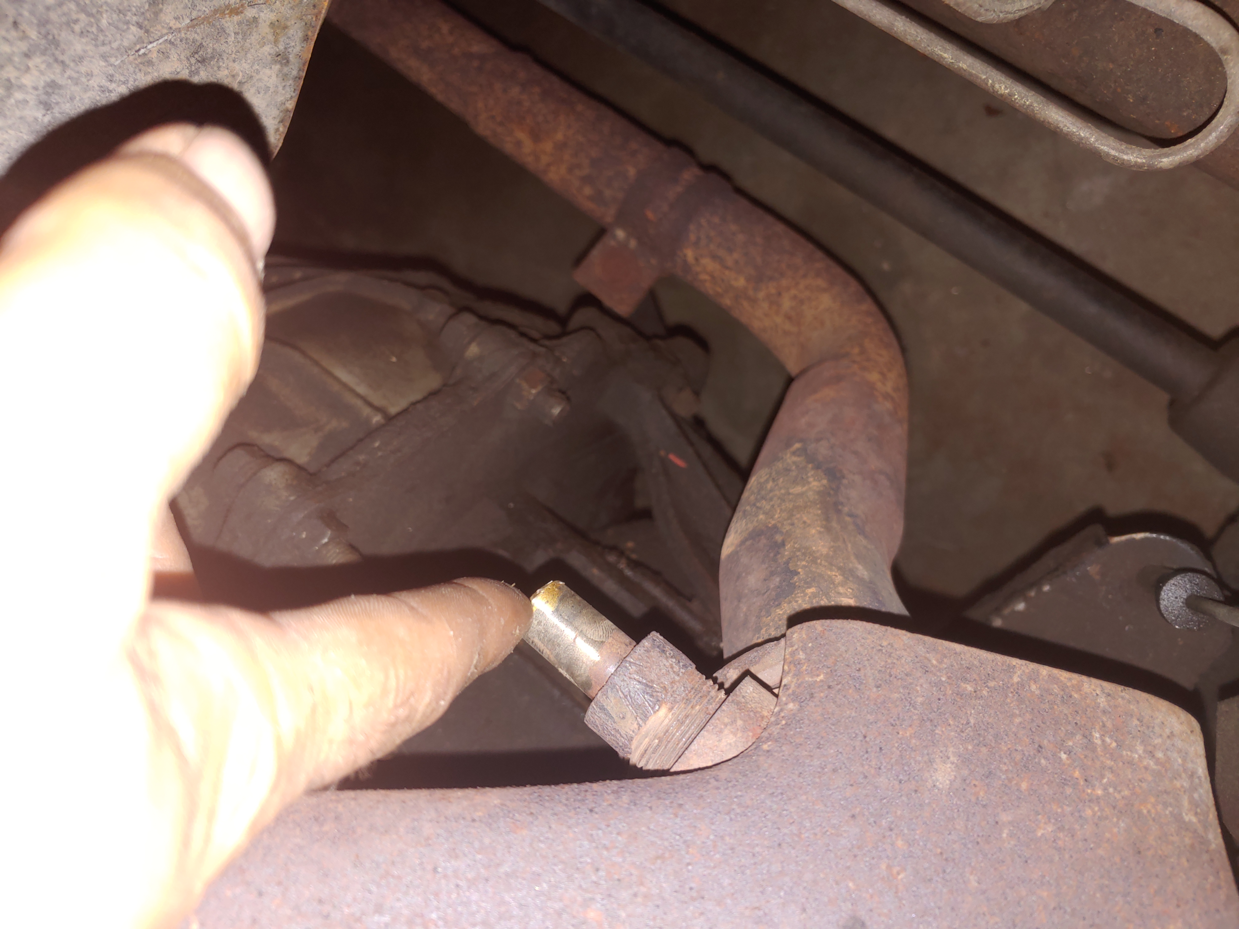

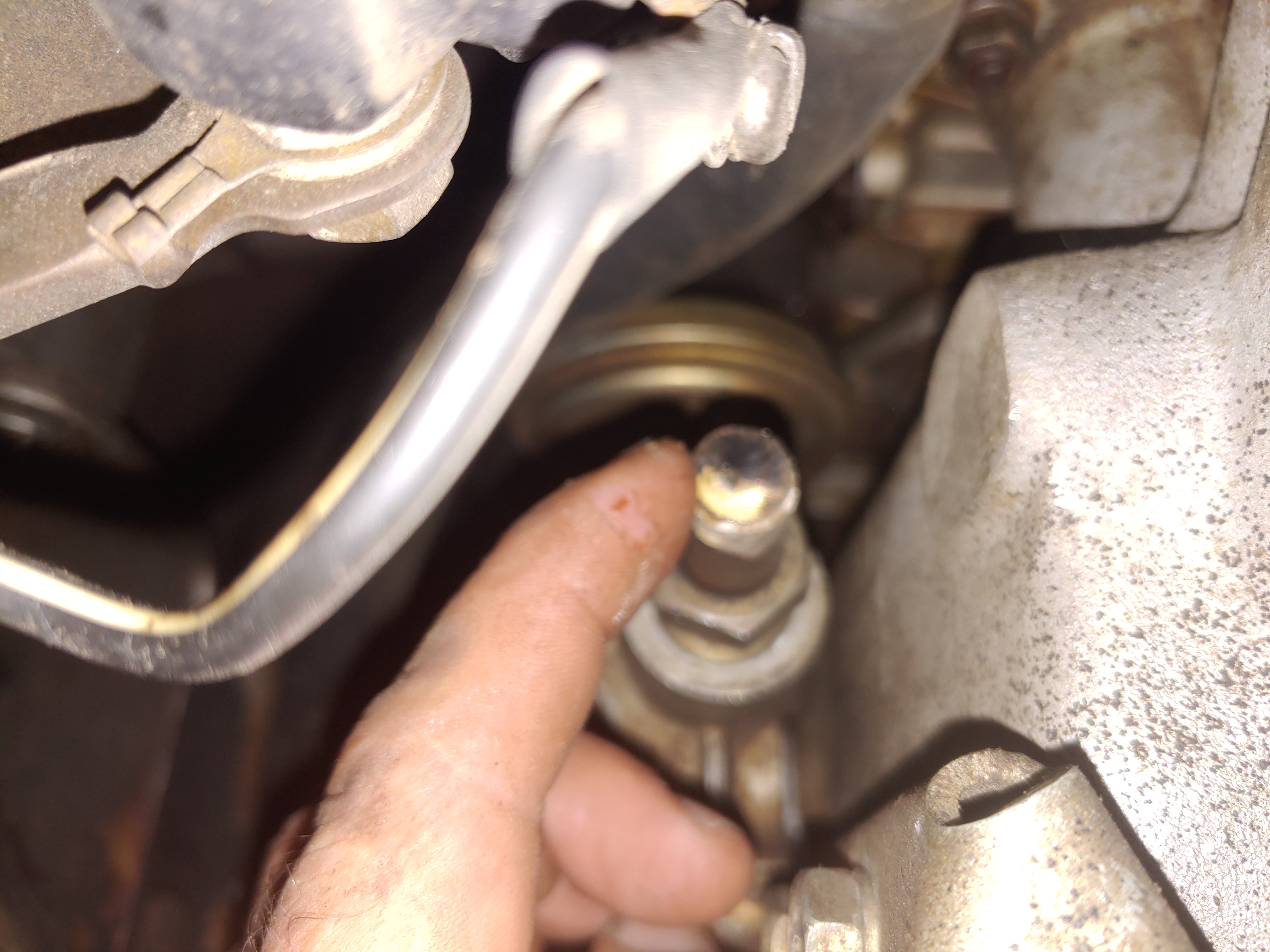

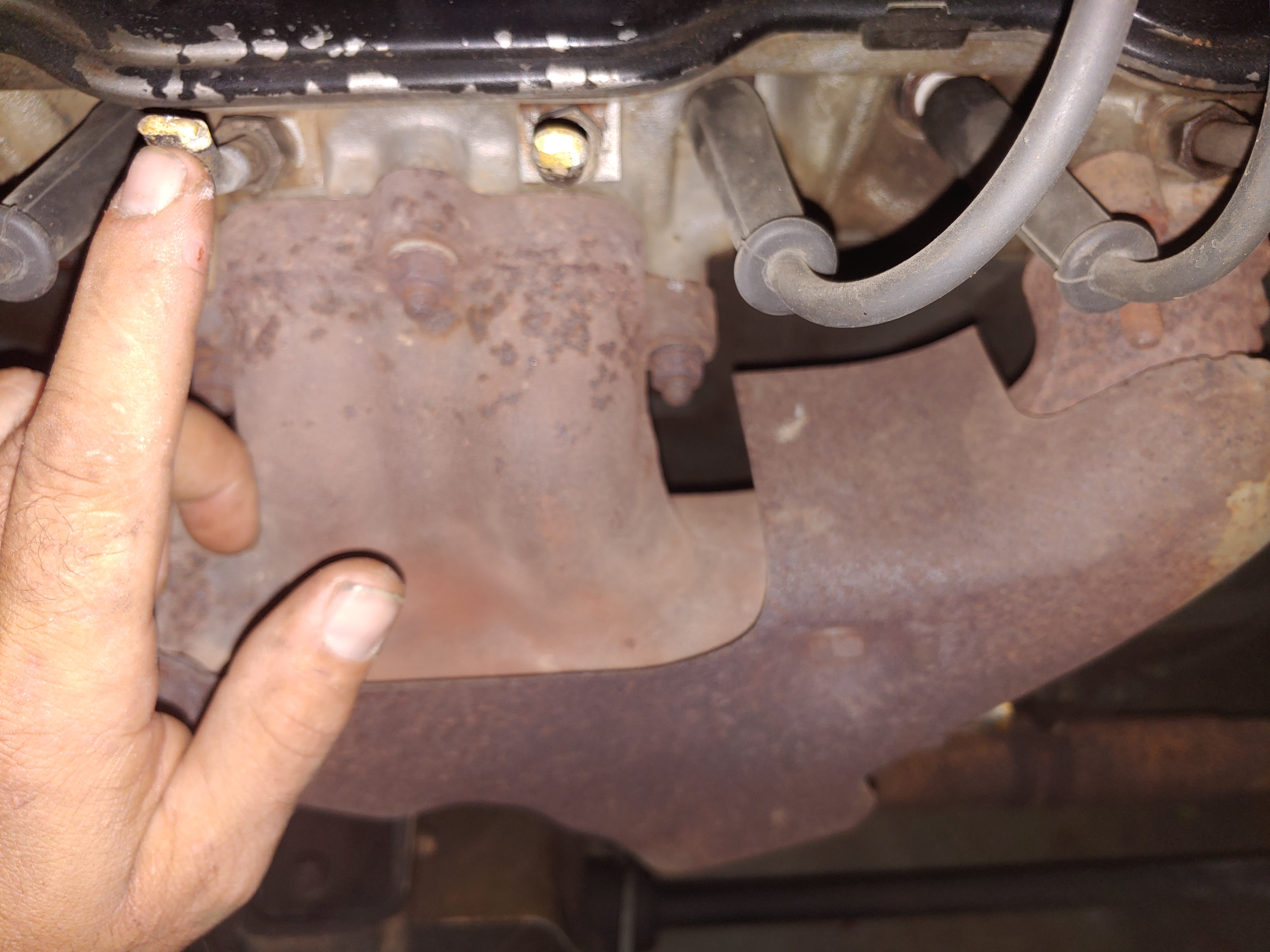

I just cut the crossover tube between the exhaust and intake and brazed in an appropriately sized bolt to close off the tube end. I then cut off the injector rail and brazed shut and reinstalled each air injector. This saved me from having to find the right covers and or plugs. Someone mentioned the air injectors can be plugged with a spark plug. I dunno, never tried that. My "cut and braze" method worked just fine on my truck.
File comment: The crossover tube at the intake. Cut and brazed shut with a bolt and reinstalled.

File comment: The crossover tube at the exhaust. Cut and brazed shut with a bolt and reinstalled.

File comment: The air injectors are cut, crimped, brazed shut and reinstalled.

I am sorry. I accidently also included information on removing the air injector rail. That is only necessary if you are deleting your smog pump. I did my egr, smog and new carb all at the same time. I forgot they were separate systems.

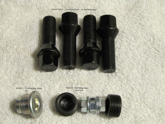

I have this smog delete plug kit for $20 shipped, payable via PayPal. PM me.
A 12mm installation tool for the EGR plugs is included & you may not need the O2 fitting plug.
Fits G180Z, G200Z, 4ZD1, 4ZE1 engines.
