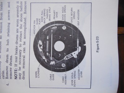

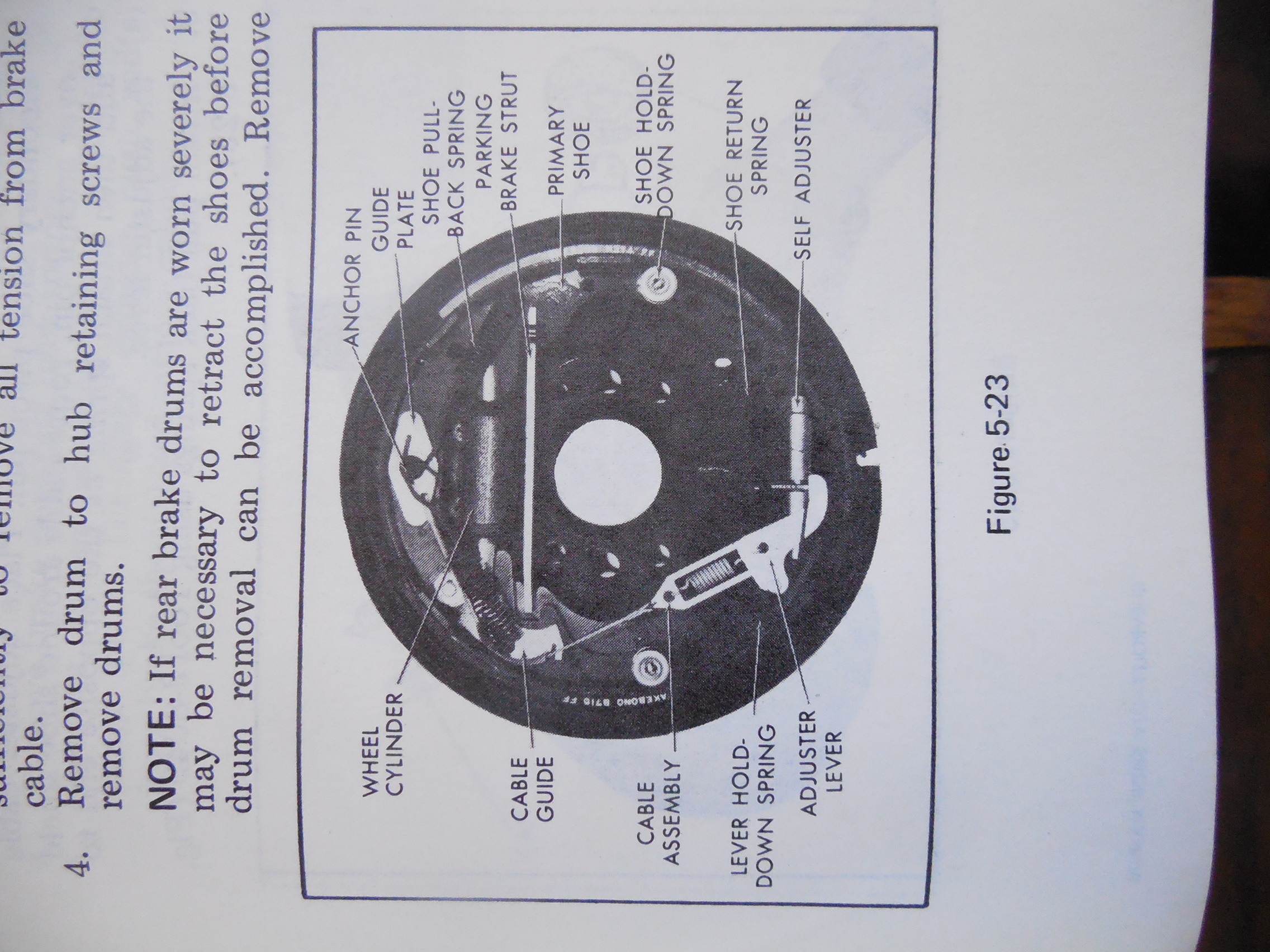

here's a couple pics front n back from a series 4 it should help you get going

That helps a ton, thank you! that wide definitely get me started

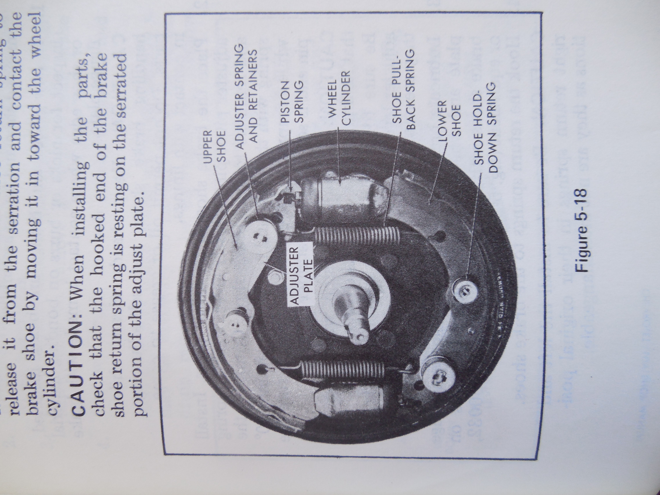

I do still need a radiator. Where are you located? Also, the only thing im not sure of on the front brakes now is how the adjusters/ adjuster plates mount. The pic 3rdLuvNext2a66MALIBU posted is a great help, but I cant see that part in too much detail. If you have any other pictures/diagrams/or angles of that, that would be great. Also, how to the brake lines split into the two wheel cylinders on the front brakes?

And I also have some good news regarding the brakes! I sat down last night and pieced it together and figured out how it works, so that is a good start. Unfortunately the previous owner took both the front drums and hardware apart and looks like im missing all the hardware and components from the drivers side. Im going to try getting in touch with him to see if he has that stuff laying around somewhere, but I may have to source that stuff from somewhere. As far as I know, they dont sell hardware kits for the front drum brakes of these trucks (I at least could not find anything). If someone else knows something different, please feel free to correct me. Thank you everyone for all the help so far, its been very beneficial! I will post some pictures later of how everything goes together just in case someone else is in the same position as me in the future.

Ok, so just in case anyone else is wondering, here is how the front brake drums are assembled and operate. I was able to figure it out after piecing it together and really studying it. I found this diagram after the fact that helped reassure me of what I was thinking (you always find this kind of stuff after you need it haha).
The adjuster plates (shown below) are held on to the back of the brake shoe with the large hold down springs. They pivot on a stud that is integrated into the back of the shoe. These move up and down and push the pads in and out. They are held in place by the unique end of the return spring that puts pressure on the end of the adjuster plate which has notches in it (works kinda like a ratchet to hold the adjustment). Definitely a unique setup, but im glad I figured it out considering I started with nothing to reference and a box full of misc parts. I am missing all the hardware (2 return springs, 2 adjuster plates, 2 large hold down springs/pins, and two small springs for the shoe to wheel cylinder) for the drivers side unfortunately though. The previous owner is looking for them, but if he cant find them does anyone on here think they might have those extra parts??
And diagrams of the whole setup
