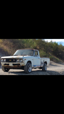

Hello, I'm relatively new to posting on forums so forgive me if all of this is been said and done already (which I'm sure it has) but I just can't seem to find it I have a 72 Luv which I'm told has a different version of the 1.8 than any other year of the luv. So here's my question 1 is there a different transmission that will bolt up to the 1.8 so I'm not near maxed out at 55 and and 2 is there any point in building the original 1.8 or should I just do the 350 swap? if I do build the original 1.8 (bigger bore, performance cam, headers, performance carb, etc.etc.) what is the average the gains I will get over the stock motor (which I think is around 70-80hp)? Any info will be greatly appreciated. :D

There are 2 versions of the 1.8. The 72-75 and the 72-82. All had 4th gear ratios of 1:1 so swapping transmissions won't do much for you.
You can swap the rear end (or just the carrier) to get a little more speed for your RPMs. All 4x4 luvs had 4.10:1 gears. Some years had 3.73:1. The 4.10 will likely be easier to find but you never know what's out there.
Bear in mind that these motors are designed to run and make their power at higher bands so swapping in 3.73s will give you more top end speed, but it'll also limit your power.
I'm a fan of doing a 350 or even a 4.3 v6 conversion. The parts are plentiful and the return you get on your investment is higher.
