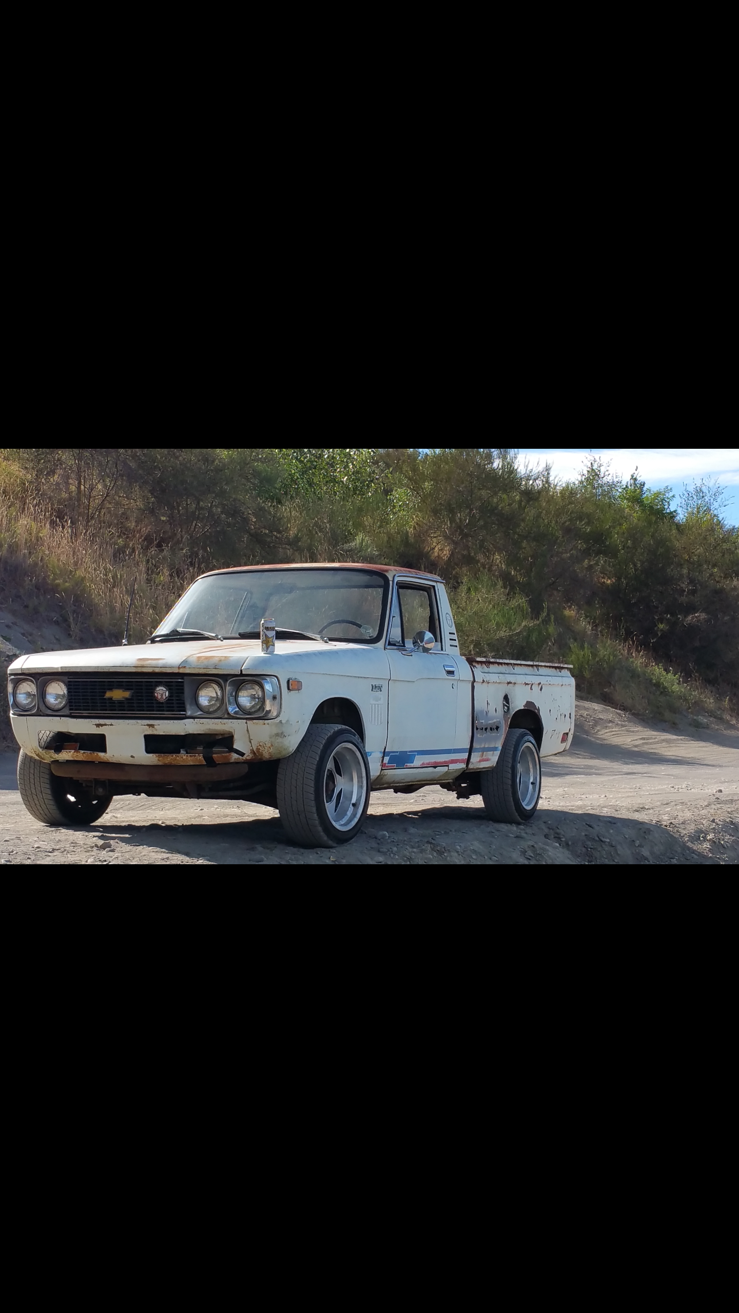

Hello, I'm relatively new to posting on forums so forgive me if all of this is been said and done already (which I'm sure it has) but I just can't seem to find it I have a 72 Luv which I'm told has a different version of the 1.8 than any other year of the luv. So here's my question 1 is there a different transmission that will bolt up to the 1.8 so I'm not near maxed out at 55 and and 2 is there any point in building the original 1.8 or should I just do the 350 swap? if I do build the original 1.8 (bigger bore, performance cam, headers, performance carb, etc.etc.) what is the average the gains I will get over the stock motor (which I think is around 70-80hp)? Any info will be greatly appreciated. :D
