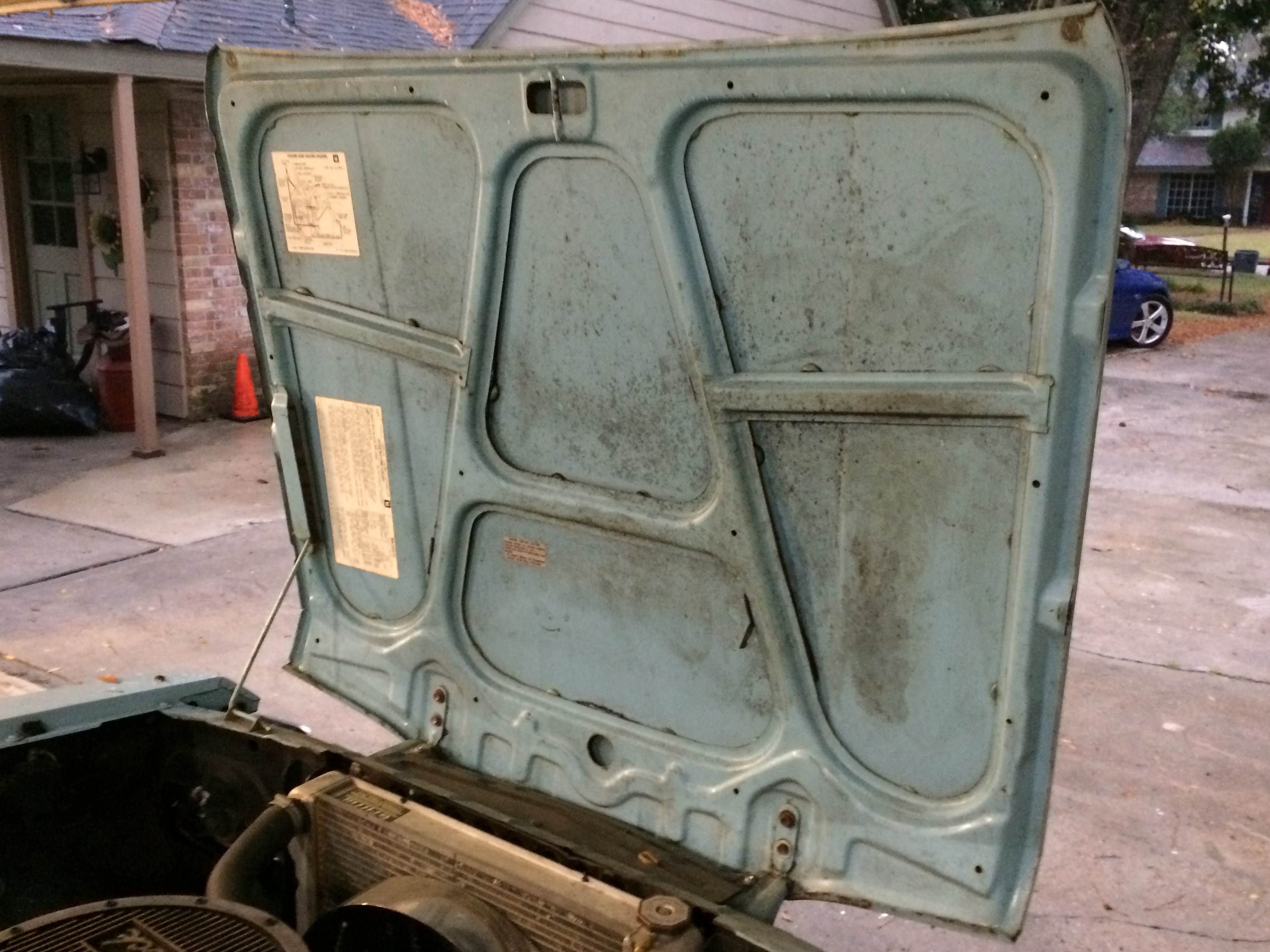

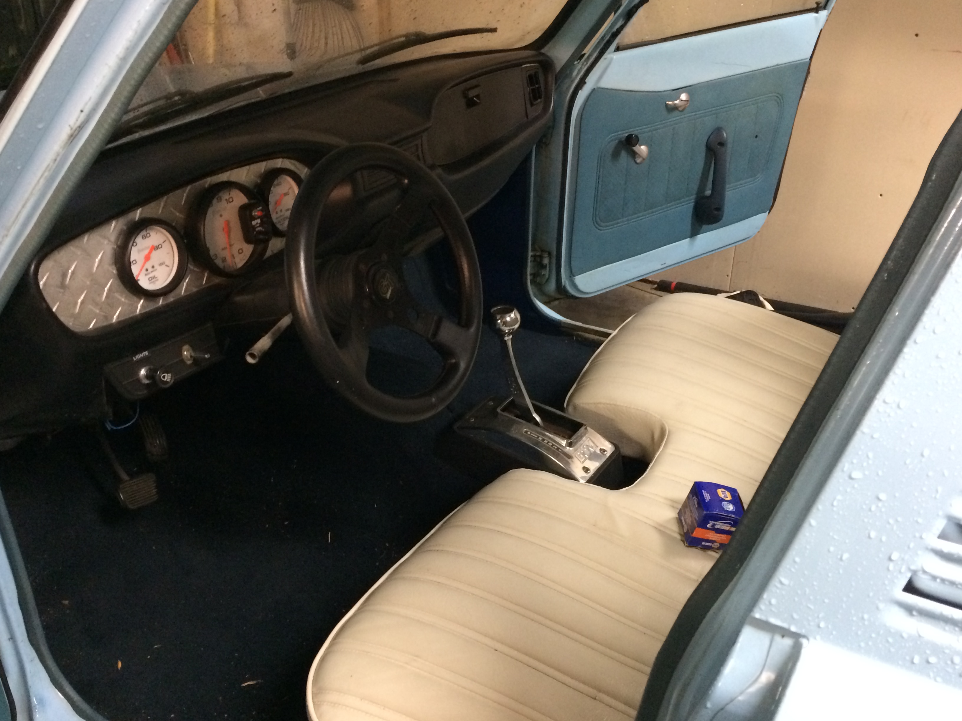

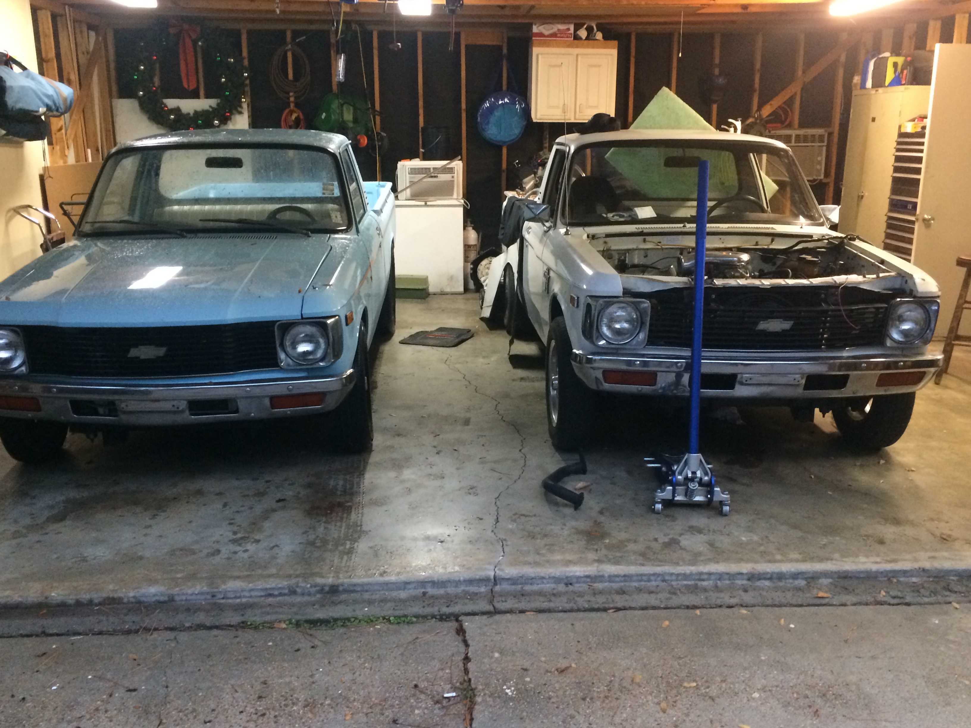

Picked up this 80 model out of Mississippi on Friday. It was an 18 hour haul from Houston to Hattiesburg and back but well worth it I will say.
Truck has a pump gas SBC 406, TH350 with a 2500 stall,7.5 with a posi and 411. Needs a little TLC as it did more sitting under a carport than driving.

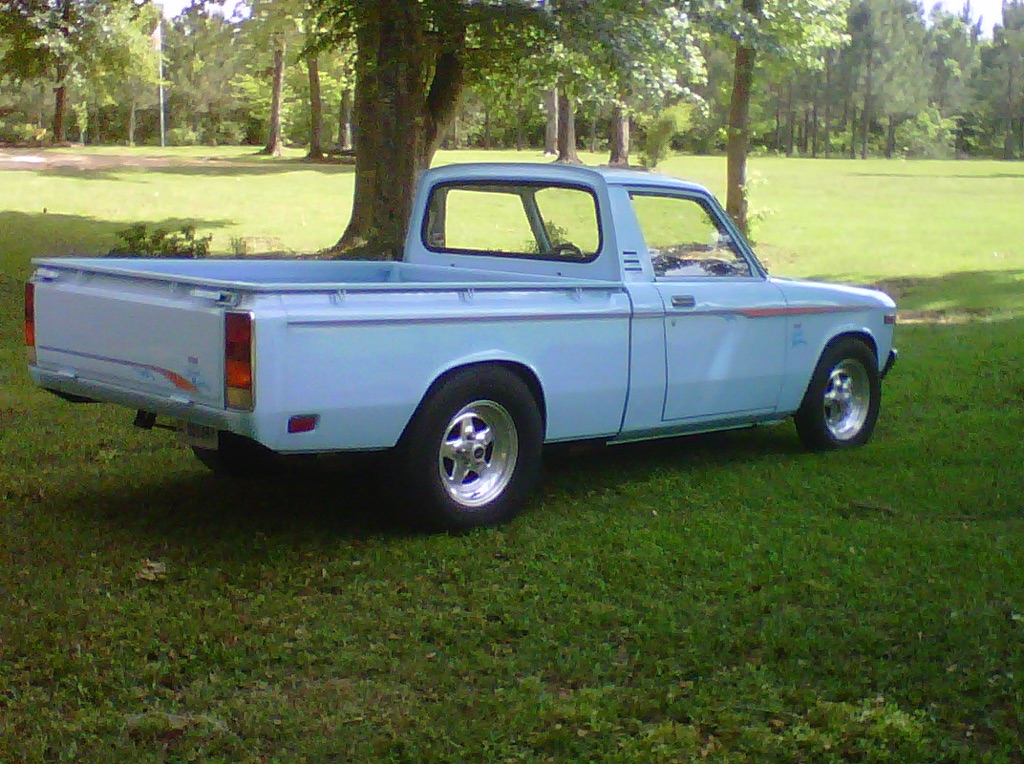

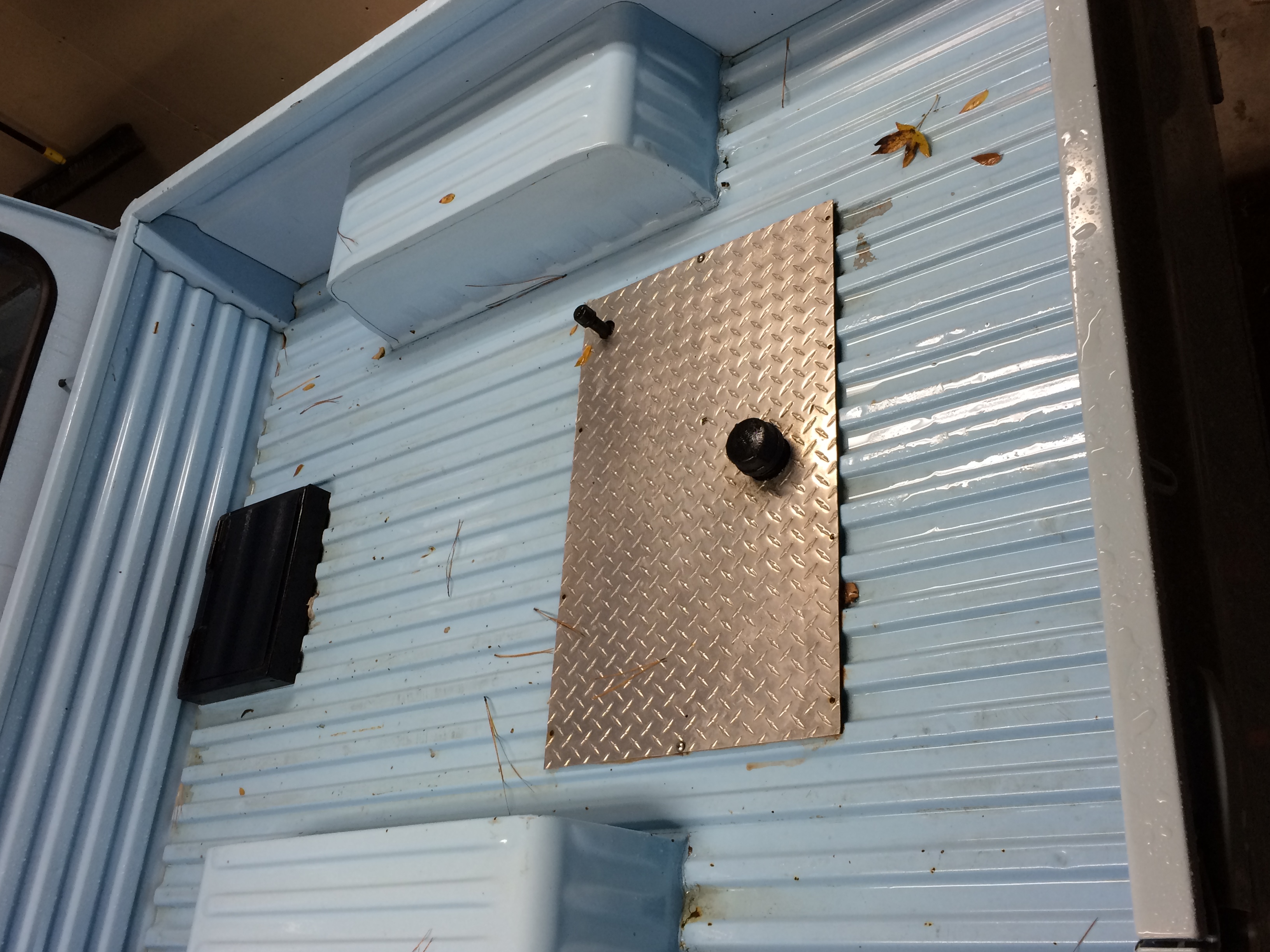

more

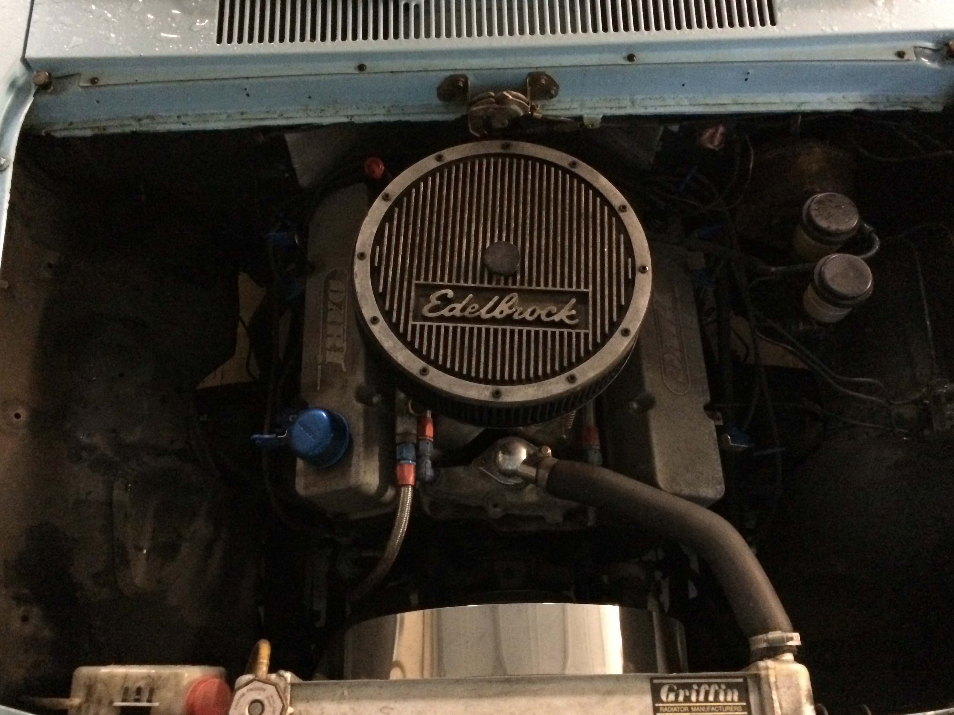

more

Trucks getting the attention it needs and deserves. Put new shocks, plugs, wires, air filter, valve cover gaskets and a 750 Holley. Had to disassemble the distributor and clean the rust out. Washed under the hood and had the tire rebalanced. Someone did a crappy job of balancing the tire as there was 20 OZ of weights on one tire alone, truck would try and shake apart at 2500 in third gear.Upper and lower ball joints will be ordered tomorrow with drag radials coming next. There is a lot more cleaning to do on the underside.
