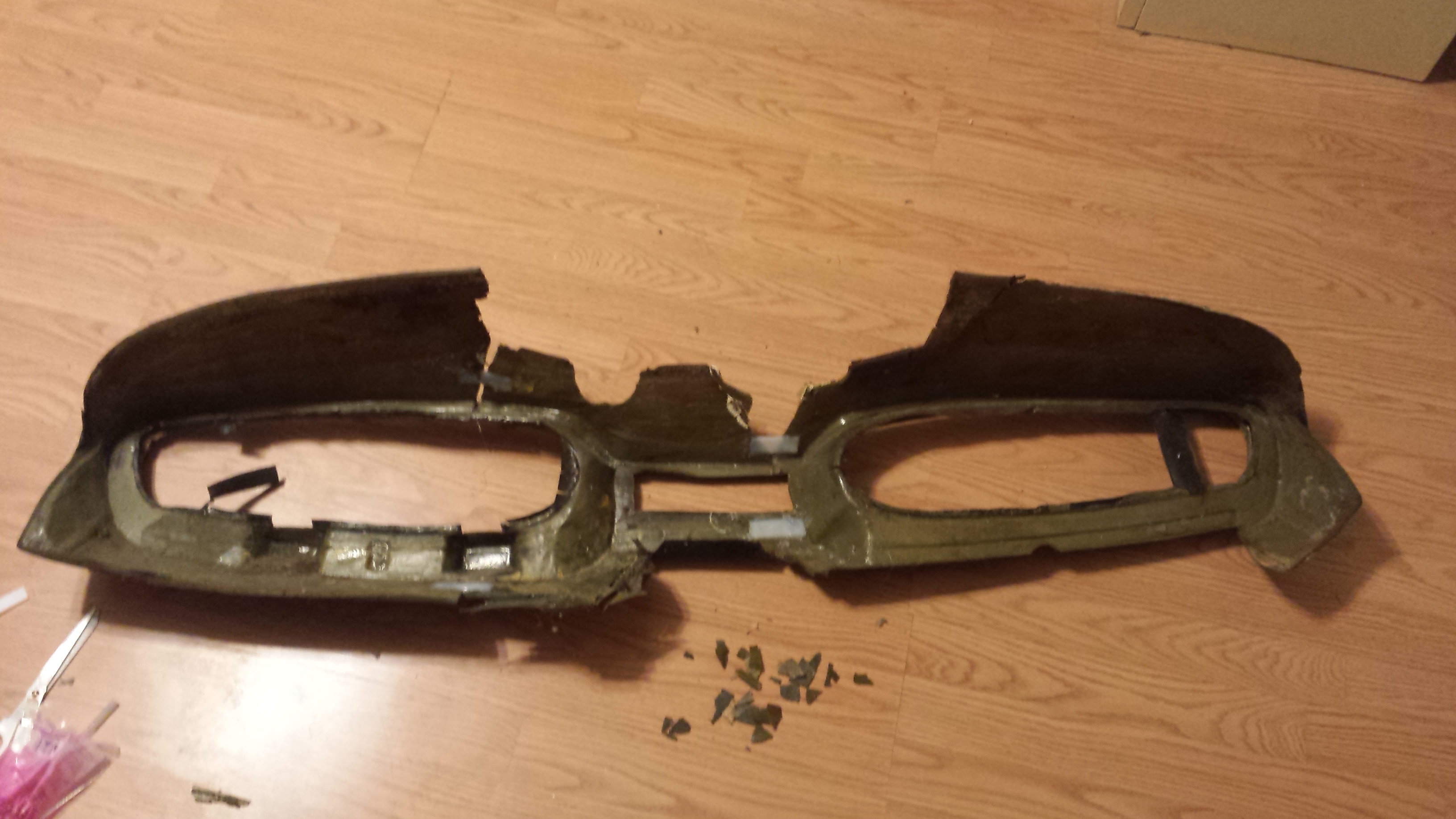

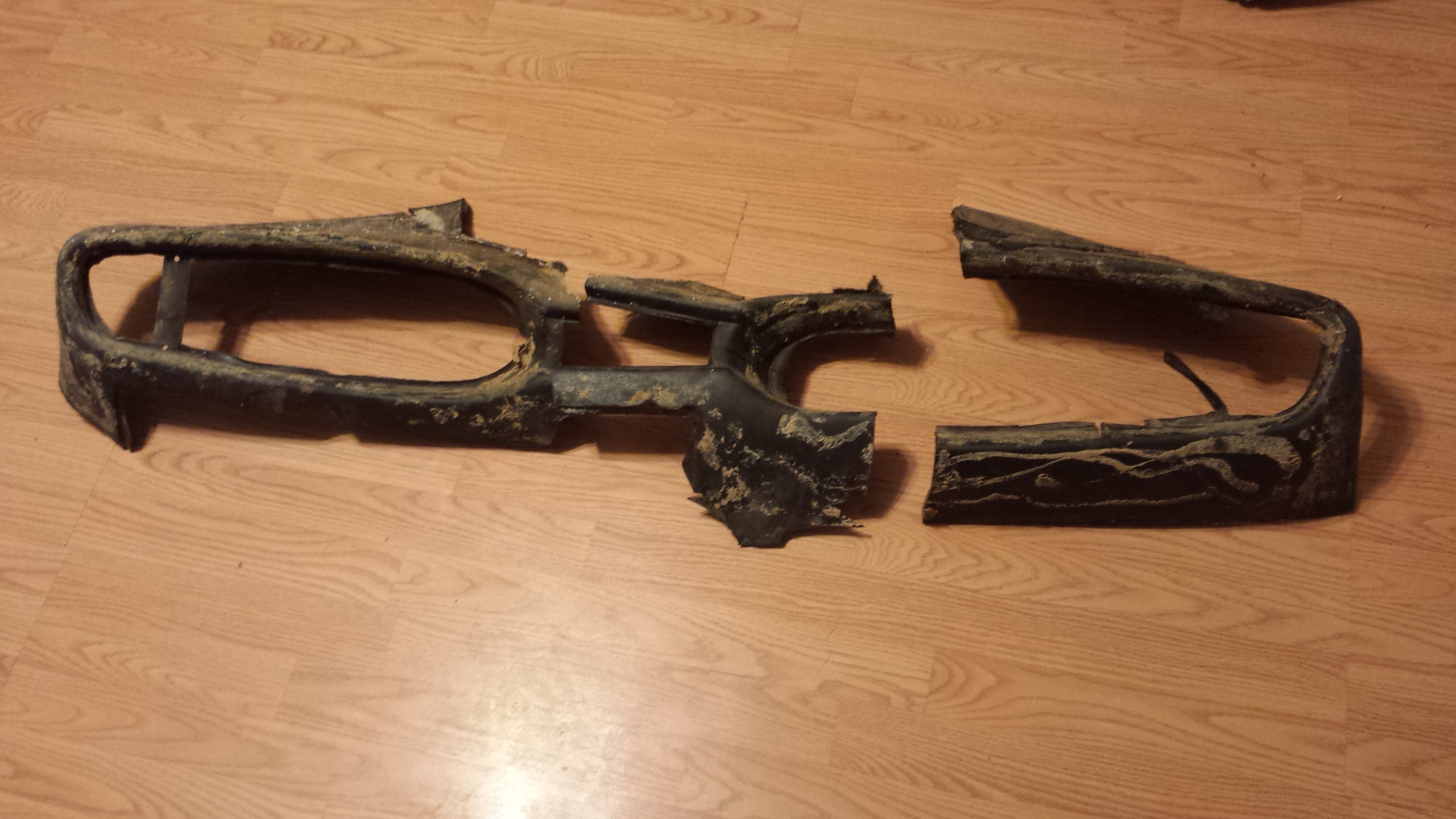

Repairing my 1980 4x4 dash. Not perfect but it will work

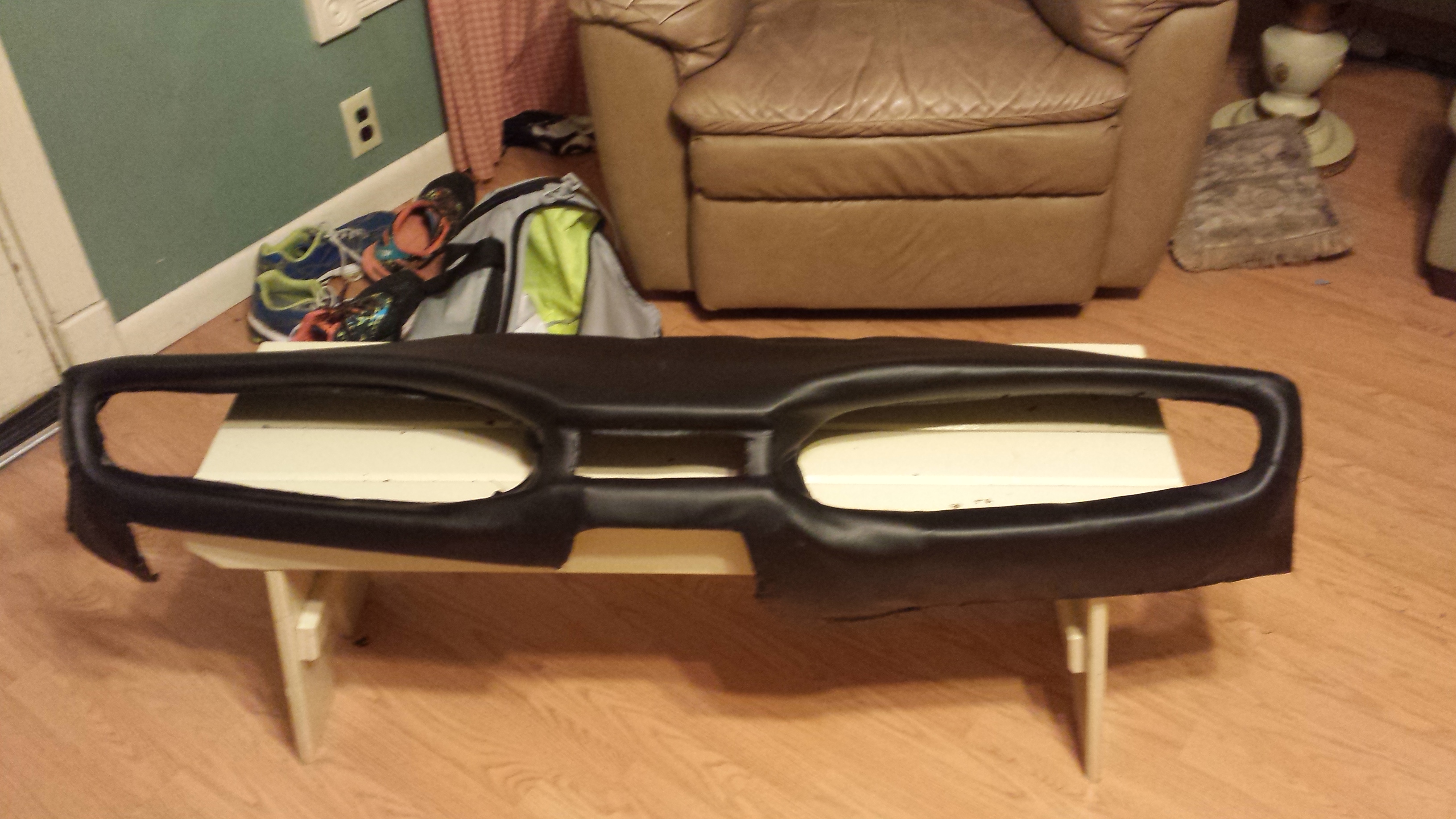

It took several hours to do it and the corners are not perfect. Glued the dash back together and inserted thin plastic strip to help hold it together. Then just sewed, glued, cut and stretched the vinyl until I got it done.

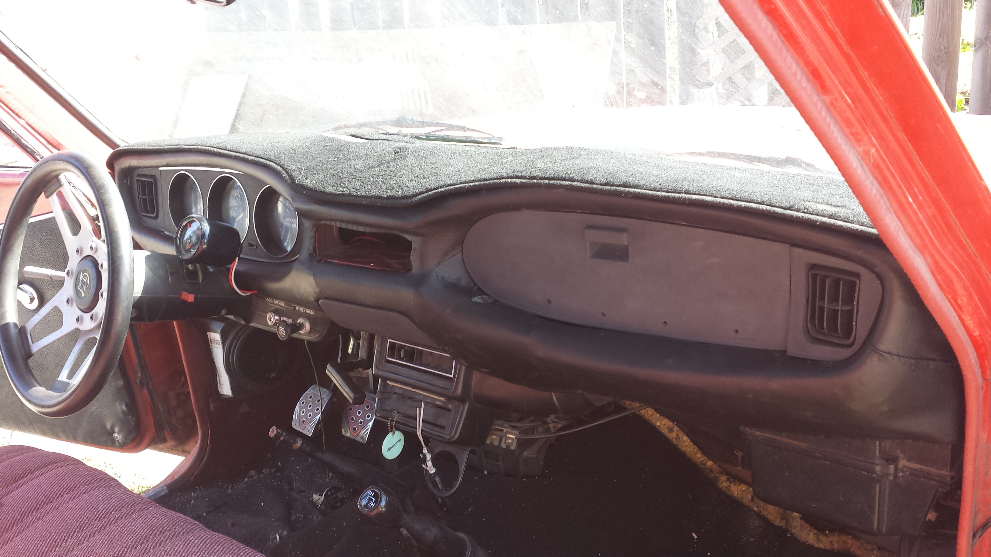

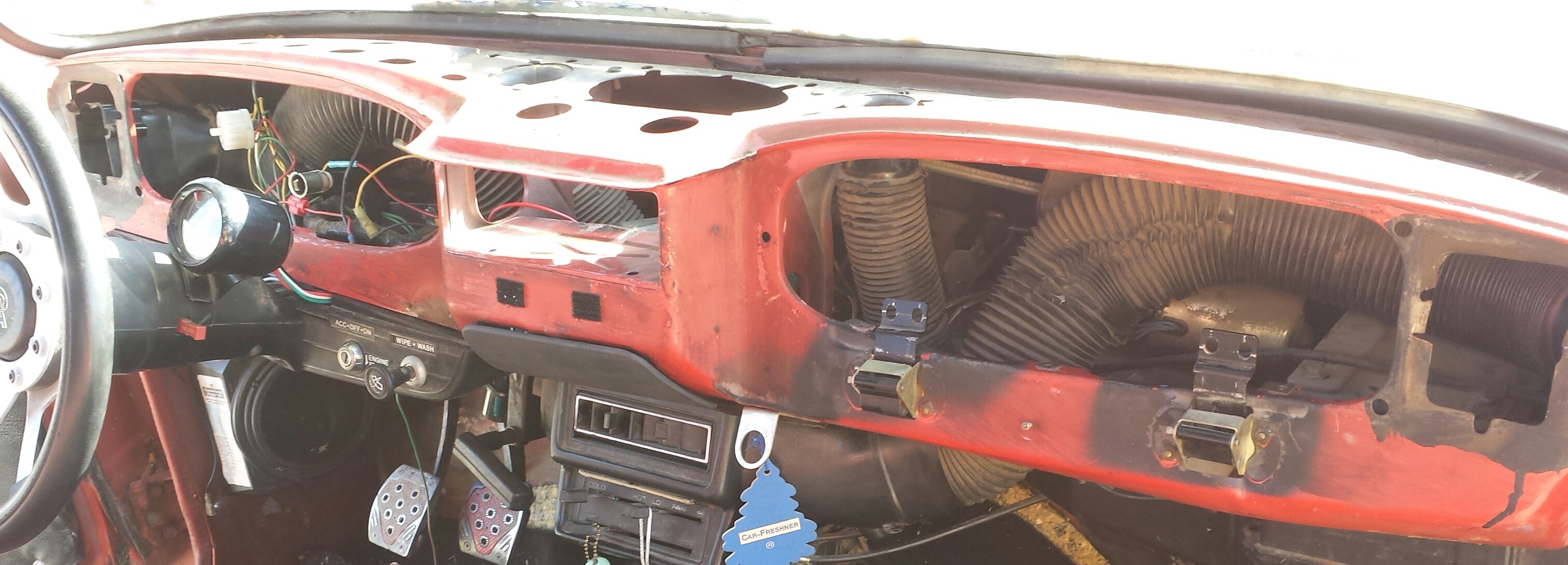

Before and after
