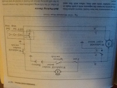

PostPosted: Fri Sep 05, 2014 8:12 pm
This is a easy circuit, crazy 2 people have this issue now.

There is no ignition switch just kill switch and push button. The motor looks brand new. I'm lost I'll try to follow that diagram again.

Update: Got a wiper motor harness out of another truck plugged it in found a good ground. Wipers work great. They dont go all the way down but i remember my old truck doing that too. Also got my heater wired up. man the guy who had my truck before me really did a job on this rewire. Solder and duct taped everything. haha terrible. Shes all cleaned up and going now! woooo whoo
