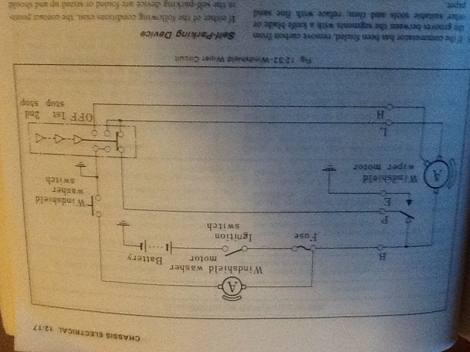

So when I bought this last truck it had the wiring harness ripped out. So i made a new harness for the wiper motor hooked everything up and got no power after the switch. So i hot tied it to each of the wires ccoming off the motor and still got nothing from the wiper motor. I need help trouble shooting further. Is the a relay I need? from the diagram it looks as simple as a hot with a 15 a fuse. Help is appreciated thanks. LUV LIFE!

This is a easy circuit, crazy 2 people have this issue now.

There is no ignition switch just kill switch and push button. The motor looks brand new. I'm lost I'll try to follow that diagram again.
