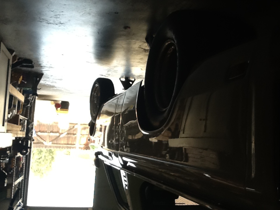

Well my flex plate is missing a tooth or two so its time to replace it. I hope I can just have a new drive replaced on my starter, there is a local place that still rebuilds starters around here so hoping they can or a new one at $250 or so will be in order. I also need to redo the alt mounting as well. I have the mount that bolts to the headers and it never really sat square. Last is a job I have been putting off too long, replace the fuel pump and run all new steel braded lines from the fuel cell to the regulator. Here she is in my garage ready to pull the transmission tomorrow after NASCAR.

It's ready for my California members to pull the trans, any takers?

Gravity is usually helpful to getting the trans out. But, now that you have the truck flipped over, it's going to suck.

That's it mytmouz, thanks for the link. And Tilted, this is why I wanted the other members to do it, I know it's going to suck.

I was laughing about the comment about the upside down picture having to take out the tranny upwards.
