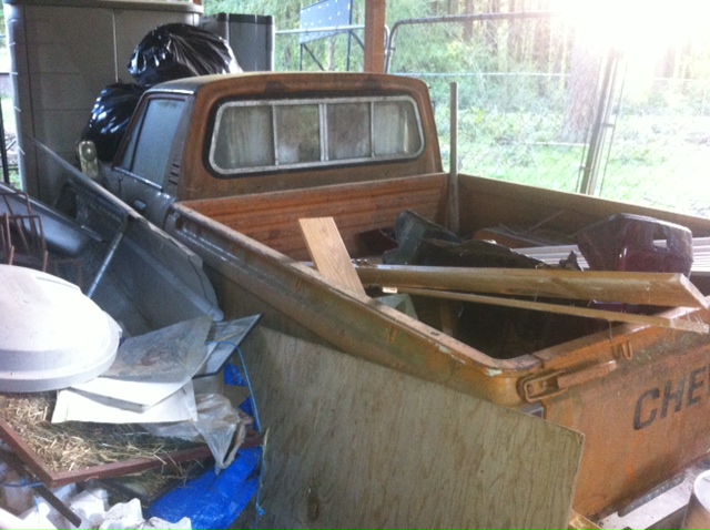

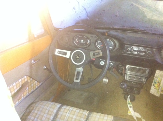

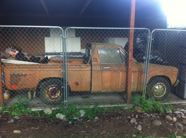

Hello: I'm new as of 17 May 2013. I'm the origional of a 76 Luv Mikado. In my opinion it is in pretty bad condition, really bad. I recently put it in Craigslist to part out. I had a couple of interested parties but no agreement yet. I think I'm having a tough time letting it go for it was my 1st new vehicle. I'm kind of ashamed to have let it get in such bad a shape. Like to get some of your opinion to part it out or to restore it. If to part it out where besides ebay is a good place to place add and what could one reasonable expect to get($) if one is not in a hurry. If to restore it, is this forum the right place. I'll attach what picture I have. What I do know is that at one time I had a cracked head and when I replaced it with a used head it started but vibrated vary badly. I think I got the timing off. I meant to fix it but life went on and the fix never happened. The bed is mostly rotted out, the seat is shot, there are two big cracks in the dash, Over the years I took a few screws, nuts and bolts for my other Japanese imports. Needs a complete paint job. The body is really straight with the exceptoin of the rear step bumper each end got slightly tweeked, and the bed sides have a lot of dents and rust. The last it was licensed was in 1995, then it sat out in the rain for 15 years then under cover for that last 3 years. I'll stop here and wait for your thoughts.

i think you should restore it. it doesnt look too bad in the pictures and with a little work you got a nice little truck to cruise around in

I'd say restore her.

Unless the entire bottom of the cab/floors are beyond repair,or the frame...then I say Build or Restore.
PostPosted: Sat May 18, 2013 7:45 pm
I agree with Ripper. It won't be worth what the restore costs, but if you want to enjoy it again you have to be your own judge on it's worth. What I'm trying to say is, as old and rare as LUVs are getting, they are not a 57 Chevy yet. If you choose not to restore it please consider selling it complete instead of parting it out. Somebody somewhere would love to have it, I'm sure. If you do choose to restore it, this is the right place for info and maybe some parts also.

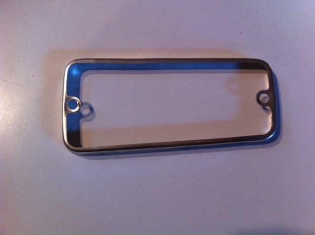

Does anyone have a side running light metal trim? One of mine is not too bad but maybe I could find one in better shape.

The side-markers were not exclusive to LUV trucks.
The same exact markers(same manufacturer and part number) can be found on other 70s-80s Japanese imports.
Not just trucks either.
I found a set on a 1978 Plymouth Arrow Hatchback.
Just sayin...

I got a set from a Ford/Mazda Courier. Somebody on eBay usually has a set or two of these at any given time. If you can't find them right now, wait a week or two and more will pop up.

Ya I found a couple listed on ebay. I'm not needing the entire light socket, lens nor the set of 2 or 4. Just the one single metal piece as in the picture. I'll keep an eye on ebay mean while I'll just straighten the one I have.
I'm kinda a hoping that someone in this group may have one in good shape laying around for a reasonable price.

If you are handy with pounding a few dents out of them they can be sanded and polished. I think they are made of aluminum. I restored a couple of mine years back and they still look good.
