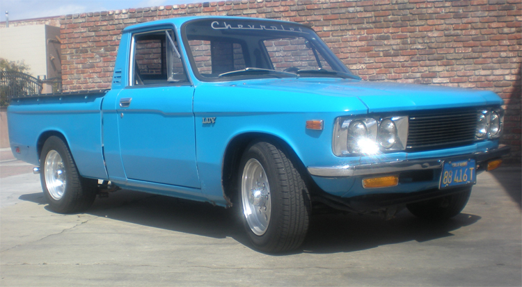

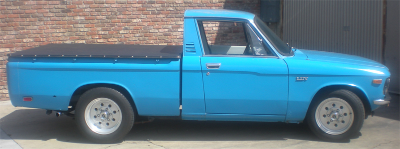

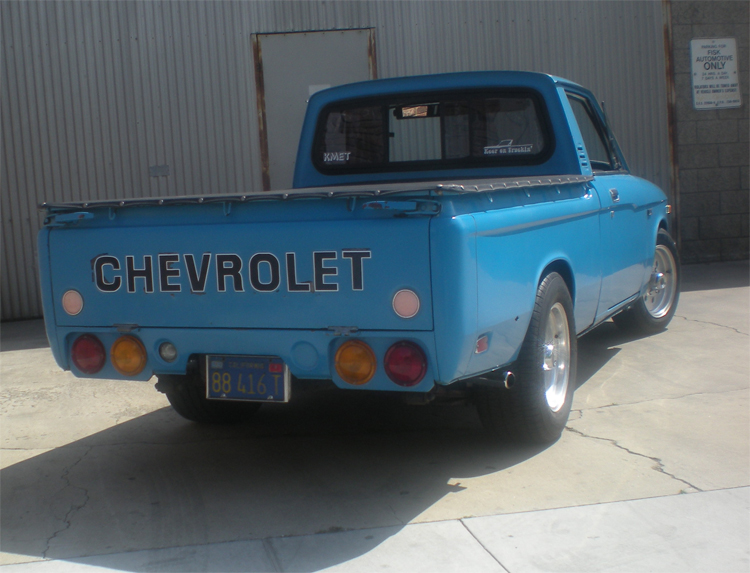

I want to thank Fabian again for hooking me up with these awesome wheels. I got them all mounted up with fresh tires and I really like them. Haven't even tried to polish them yet, I like the petina they have. Third set of wheels for this truck but these are keepers.

Does one of y'all happen to know the backspacing and offset of those wheels? Also, what tire size?

The fronts are 15x7 not sure on the backspacing (maybe 3.5) but the tires are 195/65/15
The rears are 15x8.5 and I would guess the B/S is 4.5 the tires are 245/60/15 T/A's
Like I said this is the third set of wheels I have tried and the best fitment by far, but then they were on a Luv to start with.
It will take a small army to get this truck away from me now warbeast. :lol:

Awesome, Thanks. I'm trying to get an idea of what different backspacing and tire sizes look like on the Luv and I like the stance yours has. How much is it lowered?

Thanks, It has 3" lowering blocks in the rear and the front is sitting just off of the bump stops. It rides a little nicer with some more travel in the front but I like having a little rake in it.
