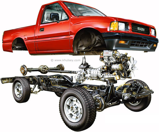

Chevy Luvs are kinda like the older brother to Holden Rodeo's, and yes they share a lot similarity's. My Luv or Isuzu KBD40 as its known in Australia has parts fitted from newer model Rodeos and Trooper's(Holden Jackaroo).
You could try theese Australian companys http://www.v6conversions.com.au/RODEO.HTM *
http://www.rodshop.com.au/ for conversion parts. Or visit http://forum.planetisuzoo.com/index.php ... 6b5d7b213b
